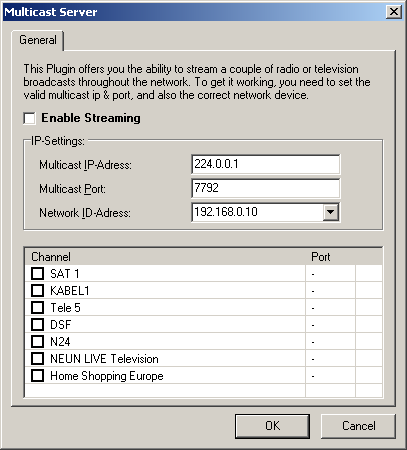

Yes, i got some source snippet from him which includes a PES size decrease solution. Hmm my one is quite similiar. Unluckily at the moment only video over multicast runs superb. I was testing this with videolan and it is running perfectly. No dropped frame and quite stable. Now i'm focusing the work on audio. Since the audiopackages i have to work with do not include es informations i have to cheat a bit. Anyhow i hope to get it run before xmas. If you (Derrick) are interested in playing with, drop me a mail..
