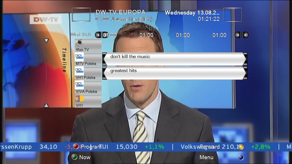

Also I played around with skin osd editor for the timeline and can't really understand the behaviour of the timeline. For example how it decides how many lines (channels) to draw at the time. This seems to change not only from the height (naturally) but also from the vertical position (Y) on the screen of the base control. Plus there seems to be a gap on top between the time display and the channels. Can't work out how to reduce it's size (see attached picture).

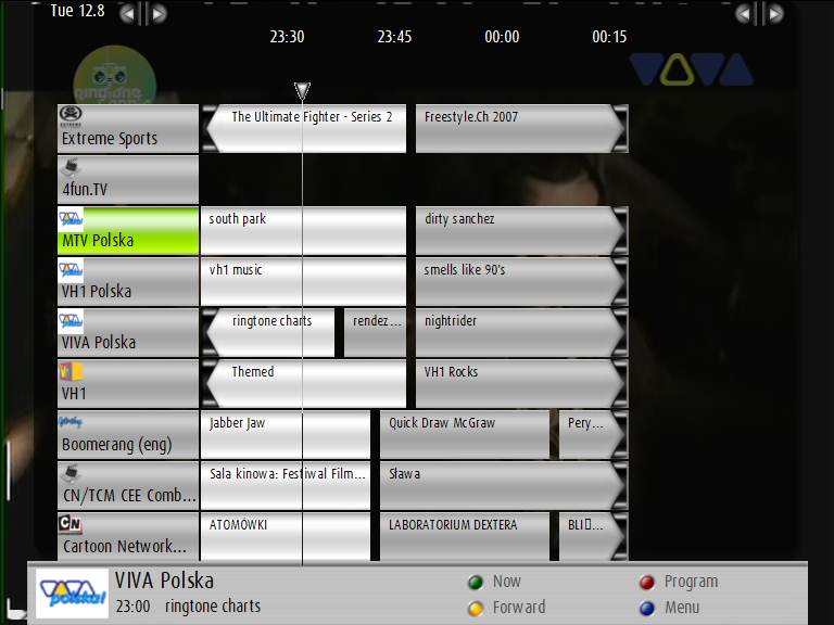

More bugs with timeline (default skin). When the X axis scale is changed (zoomed in) enough it breaks down:
1) the position of the vertical line moves to left of the screen
2) cant scroll in X direction anymore.

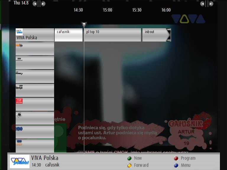

OSD Timeline when opened on the last channel in the favorite list displays pretty much invalid screen - the channel is placed on the first row and rest of the screen is filled with pretty much junk.
