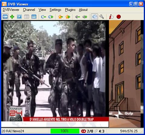

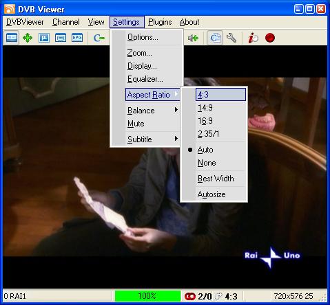

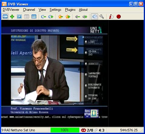

I set AR to auto (see settings attachment) but when I switch between channel with different AR the AR of new selected channel is incorrect and screen may present a zone with black or a flashing image of previuos channel (see Err and Err1).
I'm using WMR9 video renderer and 3.9.4.0 DVBViewer version.
I'm using DVBViewer from time ago with same settings and never experienced this before 3.9.4.0 version
Thanks
