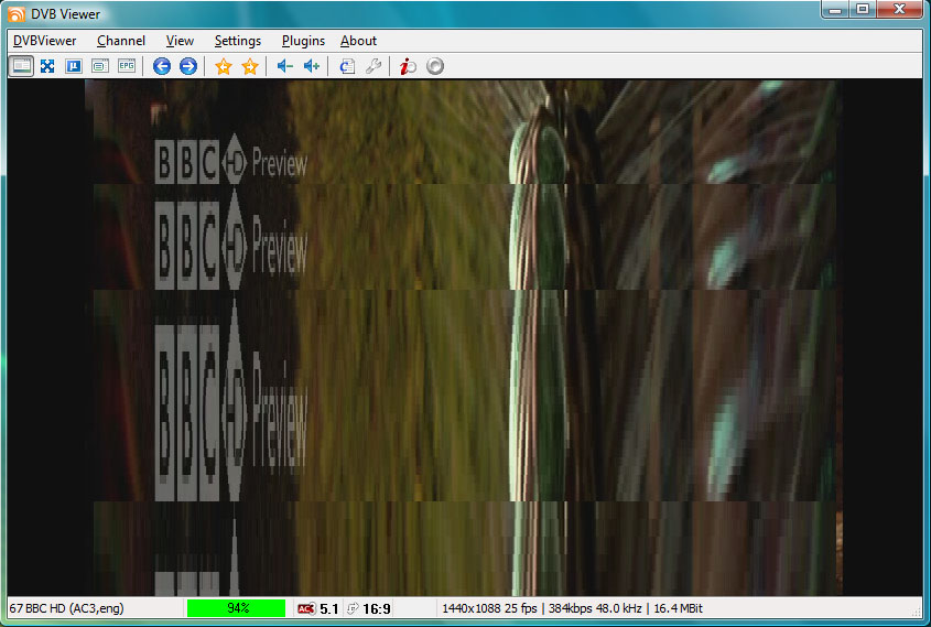

I've tried both PowerDVD8 and CoreAVC codecs but both produce very similar corrupted results. See attached images taken using Cyberlink PowerCinema codec (PCM45) and CoreAVC. I have not included a screen capture for PowerDVD codec as I uninstalled it when it provded no different to the PowerCinema codecs.
Any other suggestions anyone? Just a note, I discovered that installed RealTek audio drivers (for on board sound which I had disabled in the BIOS) were the cause of my PowerCinema crashing issues! So now PowerCinema works, with its own H.264/AVC codec and yet DVBViewer doesn't when using the same codec?
