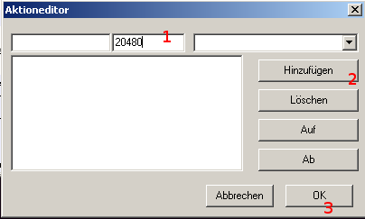

Tjod Posted September 7, 2008 Posted September 7, 2008 Not knowing what 20480 and 20481 areThe Action IDs you used in the Action Editor (thy must be 20480 or bigger).http://www.DVBViewer.info/forum/index.php?...st&p=210492 should this work with keyboard keys too?Yes for the new Actions you can learn Keyboard and Remote keys. Quote

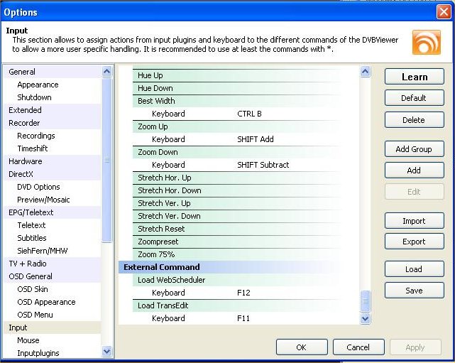

SimonP Posted September 7, 2008 Posted September 7, 2008 I followed your instructions but it still doesn't work for me. Is this the correct setting in Options? Quote
Tjod Posted September 7, 2008 Posted September 7, 2008 Should work, is Options > Scripts the scripting engine enabled? If yes, tray if the Command.vbs is started by pressing the key. Add osd.showInfoinTVpic "Test",1000 at the end of the Command.vbs. Is "Test" displayed by pressing the key? Quote
