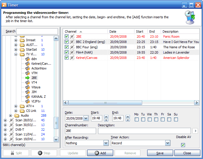

Just look at this example which I encountered right now.
I am getting a conflict where there should be absolutely none, and the only way I could solve it myself would be by buying another CI module, another CAM and another TV Vlaanderen card, have it activated, and make sure I pay a full subscription on it (because if I take a "light" subscription I 'm still not sure whether the system will not choose the wrong card, and then tell me it cannot decrypt the particular channel...).
So that would cost me : 70€ for the CI module for the Hauppauge, 90€ for the extra Aston CAM, 80€ for the TV Vlaanderen smartcard, 30€ to get it activated and then 20€/month to get the same Top package I have on my other card.
These are dazzling costs just because this scheduler does not work properly.
Going back to the example, in the setup of the hardware I have even defined that the Hauppauge card does not have a CI module, so it should never try to use that for the TV Vlaanderen channels (2Be and Ketnet/Canvas) in this example.
So when looking at it logically, it should use :
tuner 1, Technotrend with CI module and TV Vlaanderen subscription card :
2Be : 20:40-23:10, Panic Room
Ketnet/Canvas : 23:40-01:40, American Splendor
(no overlap there)
tuner 2, Hauppauge card, no CI module
Film4 : 19:55-22:20, Ladies in Lavender
BBC2 : 22:25-23:15, Have I got News for You
BBC4 : 23:15-01:40, The Name of the Rose
(no overlap there either)
Now I tried all kinds of ways to force the system to use the TT for the encrypted channels, and the Hauppauge for the other ones, but it did not seem to matter.
The conflict already started when I added the Film4 and 2Be ones, the order in which I added them did not seem to matter.
Nor did it seem to change when I started out being tuned on a TVV channel or starting out on an FTA channel.
Even starting out on an FTA channel with no rendering enabled gave that issue.
So the way it looks now is that I cannot reliably schedule a recording to an encrypted channel, even though I have 2 tuners, a perfectly legal CI module, CAM and subscription.
The only thing I have not tried yet is to define the Technotrend so that it does not accept channels from the A category, whereby it would be reserved exclusively for TVV.
But then I am permanenty assigning a tuner to the TVV setup, even though I might want to record 2 other channels simultaneously.
Please, can you do something about this in future updates ?
If you want to keep the fast zapping enabled, you could still have the user choose between the two possibilities, and if he chooses faster zapping, then grey out the preferred/normal settings.
This must really be a bug.
I tried forcing the system to use the other card for "Ladies in Lavender" (Film4, FTA channel) by keeping the other card tuned to 2Be.
Now, it is recording from both channels, even though the scheduler keeps telling me there is a conflict and that it will not record from the TVV channels.
In order to increase the chances of recording the film on Canvas, I have added another operation to tune into that channel at 23:11, just after it has finished recording "Panic Room" on 2Be.
Again according to the Timer it cannot do that, but maybe it will be the same with this time, where it says it cannot do it, and be doing it at the very same time :wacko:
Your setting is already optimal. If you just view with the technotrend card, then there is no problem, because if the card is needed for a recording, DVBViewer will switch channel (and you need to switch back, then he activates the hauppauge card). You could always perform the action "stop graph" if you want to switch from encrypted channels to FTA. With the "stop graph" action DVBViewer frees all cards that are not used for recording and then for a new channel switch command will use the preffered card again (if possible).

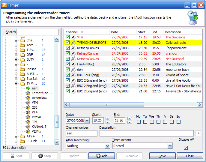

I have found a way to manually correct things for scheduled recordings (which is what I use 99% of the time).
Setup :
Tuner1 has the CI module, the CAM and the smartcard from your paytv provider, priority is set to preferred, all channels (A,B,C) are enabled on this card.
Tuner2 has no CI module, priority is set to normal, channels A and C are enabled on this card (all payTV channels are put in category B manually).
Now, suppose you start programming and you come up with a conflict in the scheduler (it turns RED in the timer window) :
For example. (first screenshot)
Now, as you can see a lot of things go wrong here, although the system has enough tuners to record everything, still things go wrong.
The reason is that at 18:20, the system chose tuner1 to record from TV5 Monde Europe, and at 19:15 it wants to record from VT4.
VT4 is an encrypted channel however so it needs tuner1 to record from that, but tuner1 is still busy (until 20:30) recording from TV5Monde Europe.
So how do we fix this manually ?
The best way is to keep tuner1 to be in use just before the system starts recording from TV5ME, we can do this by scheduling a recording from a paytv channel just at the time it would use that tuner.
The recording only needs to be two minutes or so, just enough to make sure the paytv tuner is not free, and to force the scheduler to use the other tuner.
So we make a dummy recording, just make it two minutes, and make sure you choose a PAYTV channel for your dummy recording, as that is the only way to be sure it will keep the right tuner busy.

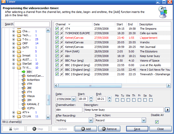

Now, when looking at the second screenshot, you can see that the dummy recording solved all conflicts but one : "L' appartement" on Ketnet/Canvas is not recorded because the scheduler chose the wrong tuner at 22:55 for the BBC2 recording "Live at the Apollo", we can solve that again by making a dummy recording at 22:54-22:56 choosing a PAYTV channel, so that we are sure that the payTV tuner is being used, and not the other card.
Notice that the system does seem to get confused after a while however (screenshot 3), as it is now telling me there is still a conflict at 19:15, and that it will not record "The Simpsons", etc., even though it is recording TV5ME (indicated by the yellow bar) with the tuner that is not using the CI module.
I 'll see if recordings are performed correctly or not, but I think this is a bug in the timer, and that recordings will be performed correctly anyway.
Edited by boulder2
Just to confirm that all recordings succeeded this way, despite the red warnings.
