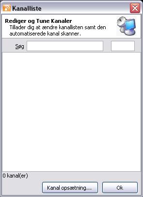

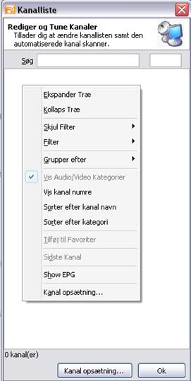

Lars Jensen Posted October 25, 2008 Author Posted October 25, 2008 Just create a dummy channel in the DVBViewer channeleditor... Thanks for your reply. It seems all so simple, but I just can't get it done. When I choose channellist i cannot se any edit-pane like, as the picture in the manual. I have attached a picture of the window I see. I have tried to right-click. The Second picture shows what I see then. Quote
Griga Posted October 25, 2008 Posted October 25, 2008 Take this empty channels.dat: http://www.DVBViewer.info/forum/index.php?...ost&id=9861 Quote
