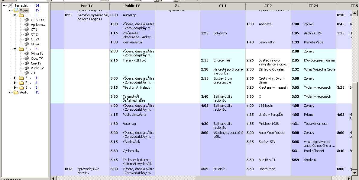

1. EPG display error. MAJOR problem.
In the Czech republic we have more DVB-T multiplex stations with different TV programs. The problem is, that when I open the EPG window, the EPG from the different programs of the current multiplex which I am seeing are incorrectly copied under the names of the programs from the other multiplexes too. The result is, that in the EPG guide there is incorrect information. This problem has the TE version. Very annoying and unpleasant.
I think that the best way is to identify correctly which multiplex is tuned and only EPG of those programs must be displayed and the other programs should not be touched or maybe greyed or similar.

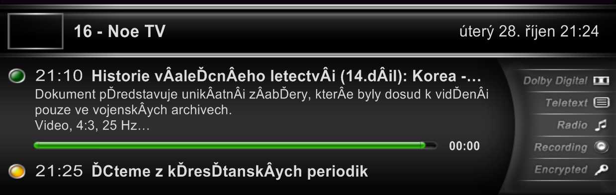

2. EPG Language problem in Pro (3.9.4) version. Major problem.
Although I have tried all possible setting, Language set to Czech, teletext set to Czech, the diacritic characters are not displayed correctly. It concerns the big black window after program change and the EPG guide and all windows itself. My opinion is, that a wrong font is selected, but it has to be investigated further.
It seems that before the diacritics change (for example e with "hook" above) the program displays some A with roof and then the character without diacritics. It is interesting that in the TE version there is no czech chars at all.

technisat2 - epg window with wrong chars

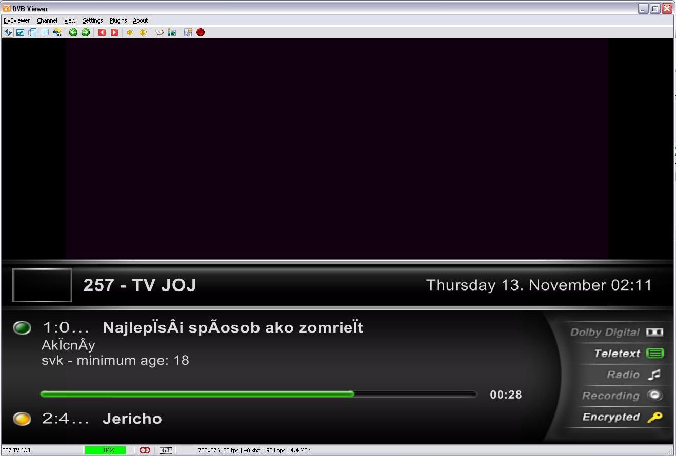

I have same problem with Slovak EPG diacritics. It is annoying that lots of letters is messed up. Is there any solution that with help you to change it? So it can be fixed in next version. Having DVBViewer for couple years and never seen anyone to mention this bug.
Correct should be “ Najlepší spôsob ako zomrieť. ”
Thanks for understanding.
