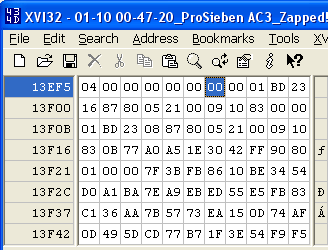

..for the 1st time I had a look at DVBViewer's ac-3 recordings. Imho the way Marfi handels this format is wrong though elecard can play it (downmix cos I don't have the nescessary harware) but no sound with windvd. The reason is that the ac-3 ES is mpeg1 audio according to the pes headers. This is wrong..
That there is a difference between atsc and dvb in this matter is simply not true. Atsc follows dvb (with exeptions). same is true for mpeg..
Please try a ts recording and demux it with projectx and then mux it to a PS (e.g. with moonlight's xmuxer (windvb will play it (w00t)))
Imho the stream has to be a private stream with 00 00 01 BD 07 EC 80 80-05 21 00 01 71 D5 in the pes hesders (from the dvbrecorder)

First, all who have problems with TMPGEnc & AC3, have a look here. It may be helpful - as I suspected, it wants a stream without this additional header.
I've already read it thoroughly, because I needed it for rewriting the AC3 recording part and decoding the AC3 frame header (starting with sync word 0B 77...). The result can be examined in the DVBViewer's status line - the AC3 audio parameters (bitrate, samplerate) are now displayed correctly.
The facts simply are:
- The DVB AC3 transport streams contains a PES header
- Neither Marfi's filter nor the MS Demultiplexer in conjunction with the DVBSource deliver this header - only pure AC3 frames.
- Adding a PS header, that declares the stream as private stream (00 00 01 BD) is not enough to enable playback - the demultiplexers used for file playback expect an additional sub-header (again with 00 00 01 BD), otherwise they won't do their job (same problem here). See how it looks like in the attached screenshot - Pro7 AC3 recorded with Marfi's filter.
- Some authoring software expects pure AC3 frames in the ATSC way without sub-header - which doesn't mean that ATSC *transmits* it in this way. But ATSC systems seem to *process and record* it in this way. Perhaps we can meet there... (w00t)
So that's the problem: A muxer like the one in the DVBViewer's recording section can not do both at the same time: Insert this header and not insert this header. Thus we need a checkbox for that...
Griga
so does the ATSC PES header 00 00 01 BD
The question about the differences between dvb and atsc concerning ac-3 are in the PSI
What is said in http://www.linuxtv.org/mailinglists/linux-...2/msg00405.html
The problem with the AC3 PES in ATSC is that they are different from
DVB PES.
is simply wrong. There are enough samples of ATSC HDTV with AC-3 recordings readily available
the same program identifying a dvb ac-3 ts recording (ZDF)
it's not about ac-3 as such but transmitting an ac-3 stream in ATSC or DVB.. The difference is still in the SI (w00t)
