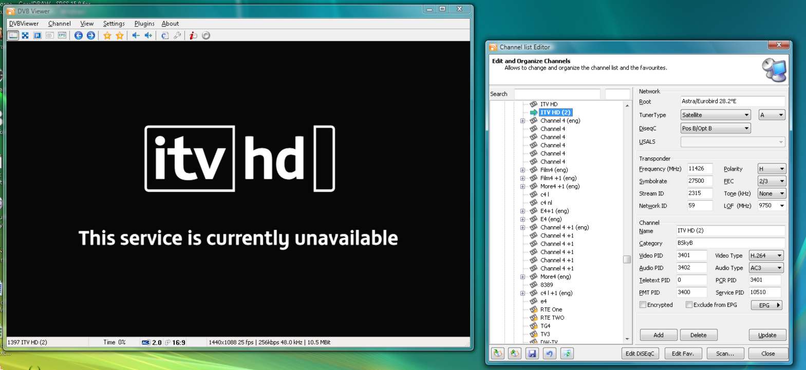

Just bought DVBViewer the other day and have been setting up all the options to suit my Technotrend S2 3650 CI usb device. I am very pleased with the software so far, and find the combination very stable (much better than my old Nebulas using XP) but I have a few queries. If anyone can help with the answers I would appreciate it.
Firstly I get all the hd channels so far available on free satellite. They all work fine, except that I can only get picture on ITV HD. I have trawled the internet for possible solutions and tried all the settings I can think of but still no better than just the picture when the signal is broadcasting. These are my current settings (see attached)post-71672-1226358768_thumb.jpg

Right click for channel editor. Try changing sound from AC3 to MPEG.
Do it when you know there's a transmission!
