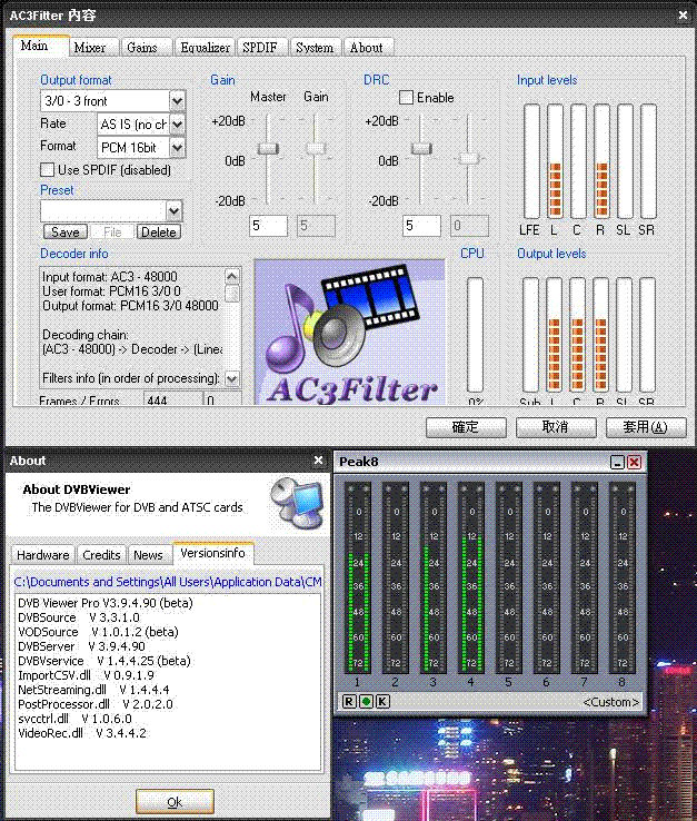

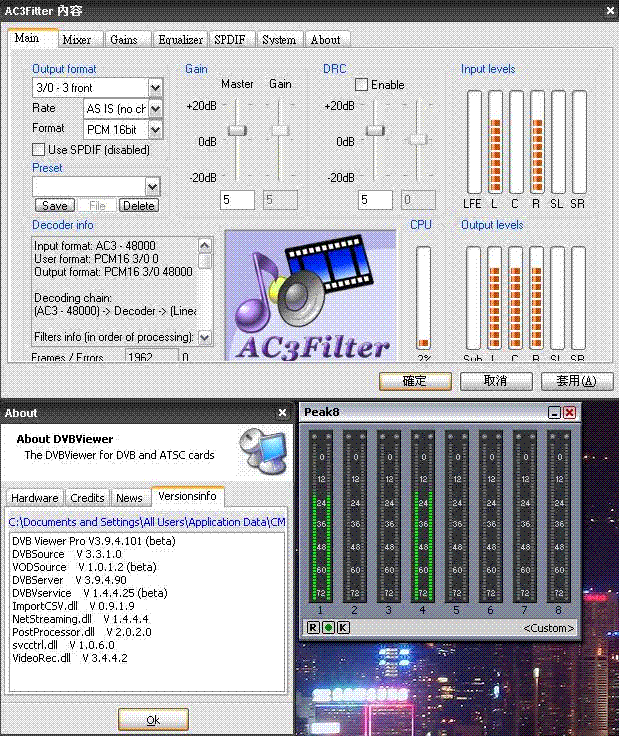

I'm using AC3 filter and set the output as 3/0 (3.0)
I notice that after version 3.9.4.90, no sound from the center channel.
My audio card is Audigy with Kx driver.
The problem still persisted with the latest 102RC.
The symptom is that AC3filter has not effect on the audio output. This happened after 3.9.4.90
a, Input 2.0 channel and AC3filter set as 5.1
Only 2.0 channel output
b, Input 5.1 channel and AC3filter set as 2.0
Still 5.1 output
I found that this happens when enable 'Use DVB clock'.
Edited by hk_ben
