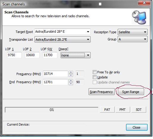

Chunksta Posted January 1, 2009 Author Posted January 1, 2009 Alec, thanks for the screen dump. When I try to use that screen I'm not offered the Scan Frequency or Scan Range buttons, they are grey and not prominent. So that's one aspect that needs resolving. Not sure if anyone else has had this problem. I can see BBC via the Windows Media Centre setup, so my dish is looking at the right satellite. Quote
Chunksta Posted January 1, 2009 Author Posted January 1, 2009 Eureka!! Uninstalled/Reinstalled and result!! OK so the install required reinstalling the Hauppauge drivers, and also my sound card drivers too, but the important bit was making sure DVBViewer scanned the transponder. Thanks for your help Alec, much appreciated!! Happy New Year all!! Quote

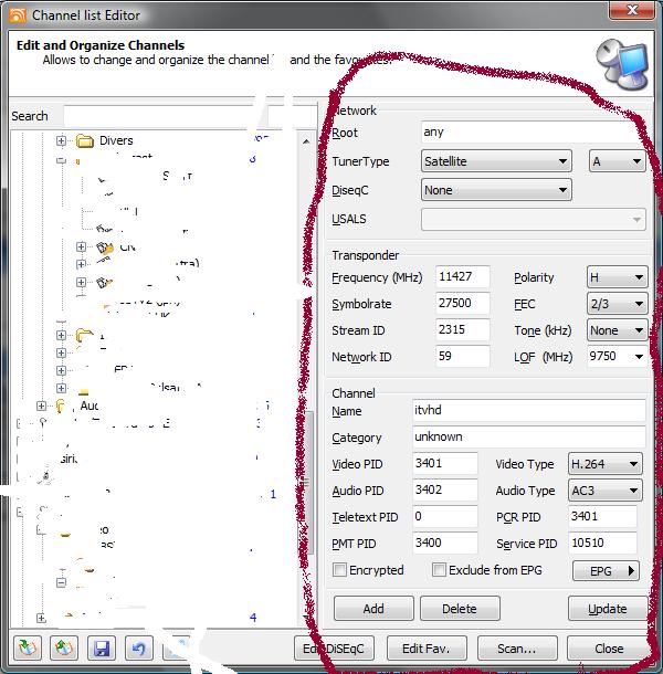

Chunksta Posted January 1, 2009 Author Posted January 1, 2009 Glad it's all sorted for you.Although U fixed it yourself-- no need to thank me m8 next step- to get ITV HD is it? Funny you should say that Alec, yes I'm now looking for ITV HD. Quote
alec1976 Posted January 1, 2009 Posted January 1, 2009 (edited) ha-ha , u wont be able to scan this ITV HD is broadcast as an interactive data stream, rather than as a standard channel, so most software will skip past it when you tell it to scan for channels ( u have to enter all pids manualy ) 1) open channel editor 2) pick ANY station 2 ) change the data 3) click add Edited January 1, 2009 by alec1976 Quote
Chunksta Posted January 1, 2009 Author Posted January 1, 2009 Alec, You diamond!! Thanks for your help. Now edited the channel list. Quote
