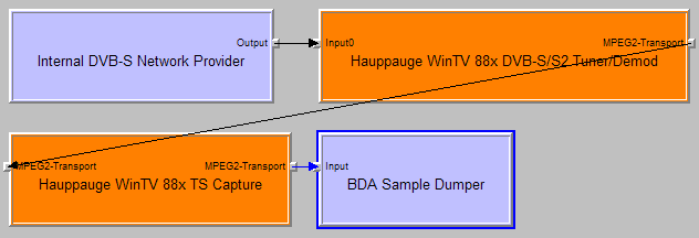

Griga Posted February 10, 2009 Posted February 10, 2009 In case the genpix devs are interested: The screenshot below shows a typical DVBViewer BDA capture graph in Direct Tuning Mode, leaving as much as possible of the MS stuff aside. Internal DVB-S Network Provider is a DVBViewer component replacing the MS Network Provider. It implements IBDA_NetworkProvider, but only performs basic configuration of the tuner filter via IBDA_Topology, thus skipping most of the MS BDA overhead. BDA Sample Dumper is a DVBViewer component receiving the TS data from the Capture Filter. The rest are MS KSProxy filters working as DirectShow wrappers for the DVB-S BDA driver. DVBViewer queries them for the interfaces mentioned above and does the tuning... Quote
hellsingfan Posted February 10, 2009 Author Posted February 10, 2009 Its not like I'm a coder, so most of this goes over my head except the last part which you gave an image, seems like the tuner is being used through a directshow filter? I think DvbPlus utilizes that which is totally based upon Skywalker. Anyhow I've asked genpix to talk here, hopefully he'll come. Quote
