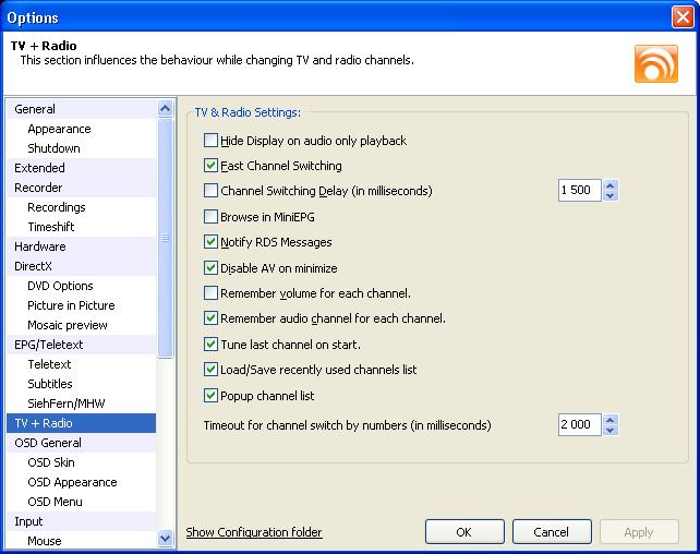

Andrey123456 Posted September 6, 2009 Posted September 6, 2009 (edited) I got this card and tested in my computer. It works with latest DVBV, but before it started to to work it made a lot of mess in my system. I didn't do long time stability test yet. Sequence to operate it if following: - install wdm driver - install card software (from cd or whatever) - apply fixed IP to new technisat network adapter (i.e. 192.168.200.2 mask 255.255.255.0) - be sure that there is no conflict with your existing network adapter (i.e realtek ip auto, supposed to be in range 192.168.0.100 - 192.168.0.110 mask 255.255.255.0) if your network adapter will become crazy, uninstall it from device manager and install back. Update diver of course/ - install DVBV -select Technisat card in hardware section - watch tv if there is no other bugs My impression - not the best DVB card, but it costs almost half of mt TT-S2-3200. Even if it has some bugs, it is worth the money it costs. Edited September 6, 2009 by Andrey123456 Quote
Andrey123456 Posted September 6, 2009 Posted September 6, 2009 (edited) Next step - improve stability - remove from startup folder (start->all programs-> startup) Server4PC program. - restart computer. - set DVBV optoins hardware and tv radio tabs according exampes. Stability test was 210 channel switchings without any error. DVBV is still running without any problem Edited September 6, 2009 by Andrey123456 Quote
