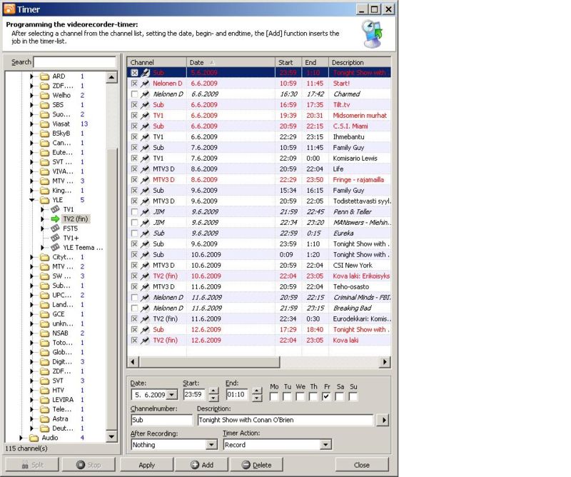

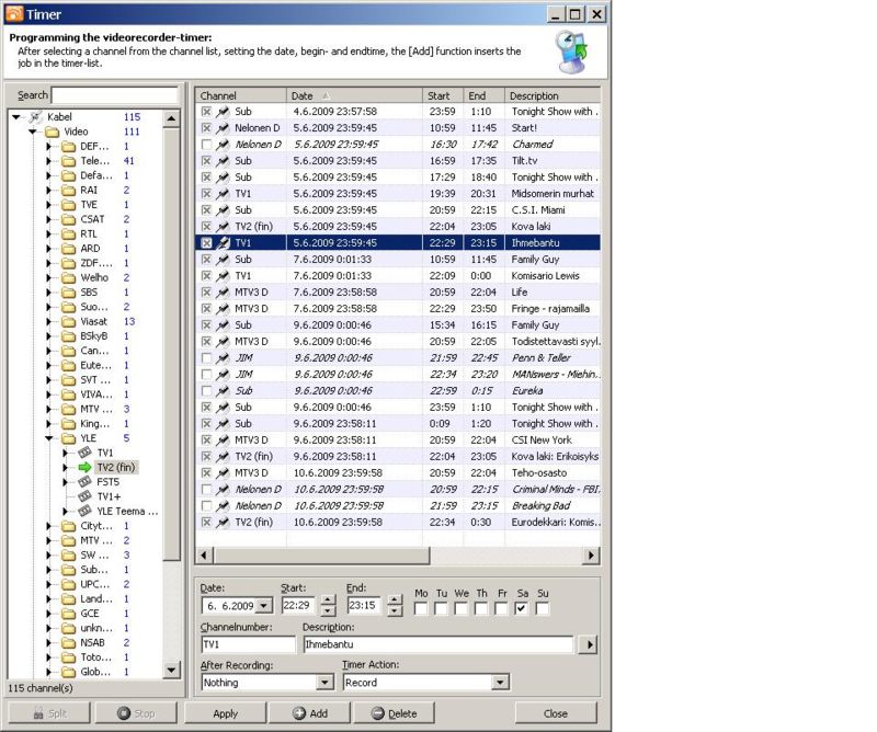

I noticed the timer wasn't working. When I open the timer window it has scrambled information, picture attached "Recordings_tilt.jpg".
After I close and restart DVBViewer the timer window is back to normal, picture attached "Recordings_after-normal.jpg".
Did not have any problems with v4.0, problem started appearing when I updated to V4.1.1 .
Happens several times a week, at least every second day :) . Makes the timer completely unreliable.
explain what scambled information? there is nothing scrambled.
The date is wrong by at least 1 day and there is a random time after the date. For example 4.6.2009 23:57:58.
Didn't think of a better way of saying it, sorry :) .

Happens always when CoreAVC 1.9.5+Cuda acceleration is used with DVBViewer. Clearly some kind of incompatibility problem. Didn't notice the cause before because I only use CoreAVC when randomly watching music videos in mkv containers.
