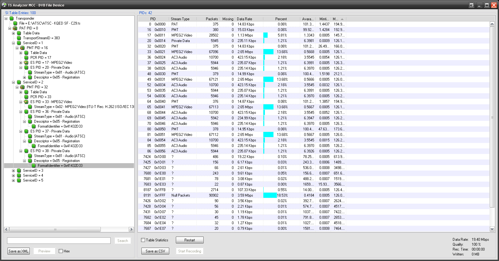

antdude Posted June 20, 2009 Author Posted June 20, 2009 (edited) Hmm, all my TS Testdumps here are working fine - okay they are quite outdated (made in 2006 when i was in Houston/TX respectively SF/Bay Area), but they work like they should. I'm quite unsure which might cause the Problems thats why i would like to need some informations: 1. load Transedit 2. extract the attached zip under Transponders in the userdata folder, 3. select America ATSC in the list and choose the frequency with the channel which does not play audio 4. press analyze If everything is "fine" you should see the following: What we need is the ES Information of each Service, you can dump the information via save as xml. Christian I am doing KNBC with its frequency of 605000. I assume that 605 MHz since I couldn't find 605000 nor can I enter it manually. No AID seems to match. Attached. I hope I did it right! Edited June 20, 2009 by antdude Quote
hackbart Posted June 20, 2009 Posted June 20, 2009 Hmm, the format identifier is not set like it should. For AC3 it should be 0x332D4341, but in this case it is 0x41432D33. Which means to be correct it is more an 3-CA than AC-3 stream Should be fixed in the DVBViewer as well the other applications. Once the next beta is published you should check that out... I also found some smaller issue which caused a problem with identifying the channel name in the VCT table. The reason was that the serviceid value was not correct, so i compare a channel by using the program_number - which was working on all of my test streams here. Christian Quote
antdude Posted June 20, 2009 Author Posted June 20, 2009 Hmm, the format identifier is not set like it should. For AC3 it should be 0x332D4341, but in this case it is 0x41432D33. Which means to be correct it is more an 3-CA than AC-3 stream Should be fixed in the DVBViewer as well the other applications. Once the next beta is published you should check that out... I also found some smaller issue which caused a problem with identifying the channel name in the VCT table. The reason was that the serviceid value was not correct, so i compare a channel by using the program_number - which was working on all of my test streams here. Christian So, what's the workaround for v4.1.1 while I wait for the next beta? And any ETA on the next beta? How come TE didn't have problems? Am I the only one with this problem? Quote

antdude Posted June 20, 2009 Author Posted June 20, 2009 (edited) Hmm, the format identifier is not set like it should. For AC3 it should be 0x332D4341, but in this case it is 0x41432D33. Which means to be correct it is more an 3-CA than AC-3 stream Should be fixed in the DVBViewer as well the other applications. Once the next beta is published you should check that out... I also found some smaller issue which caused a problem with identifying the channel name in the VCT table. The reason was that the serviceid value was not correct, so i compare a channel by using the program_number - which was working on all of my test streams here. Christian 4.2 beta did NOT fix the audio problem or maybe I did it wrong. Attached CSV and XMLs from KNBC4 again. I also included a channels for "service" name (allother channels appear to be correct -- yay, no more renaming). I am not sure who owns this one or maybe too weak since I saw a lot of missing values. Edited June 20, 2009 by antdude Quote
hackbart Posted June 20, 2009 Posted June 20, 2009 Can you create a small complete transponder dump (not more than 100mb are required)? You could upload the zipped file on rapidshare for instance. Christian PS: Did you have done a rescan of the channels and do you have a working AC3 codec installed (yes i know this is a dumb question, but we need to excluse possible other problems) ? Quote
