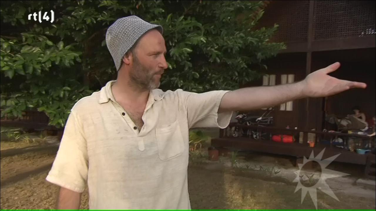

I experience screen corruption in DVBViewer Pro when viewing in fullscreen. I get a green bar at the bottom of the screen.
This happens after I change a channel. The problem in most cases goes away if I switch back from fullscreen to windowed and back again.
It doesnt depend on the channel, SD/HD, or videodecoder. It also occurs in both recording and timeshift.
Zooming also has no influence.
It does depend on the renderer. I get it when I use EVR, and Overlay, but not when using VMR9 with the Nvidia VMR fix ticked.

Try altering "Image Hight"....
The green Bar is part of the so called " blanking interval" wich is not vsible on normal TV-Recievers due to the Overscan.

Thanks for the response.
I allready tried it, but no luck. It doesnt seem to be part of the file, since when I open it in vlc/powerdvd it isnt there (overscan/zooming disabled).
Also, I also dont get it in DVBViewer when using VMR9 (with vmr fix enalbed)

I have the same problem, the problem disappears then I turn off DXVA, also where is no green line then use BOB deinterlace, but the picture is not clear then.
ATI 4550 CCC 9.6
Vista Ultimate x64
PDVD 9
EVR
