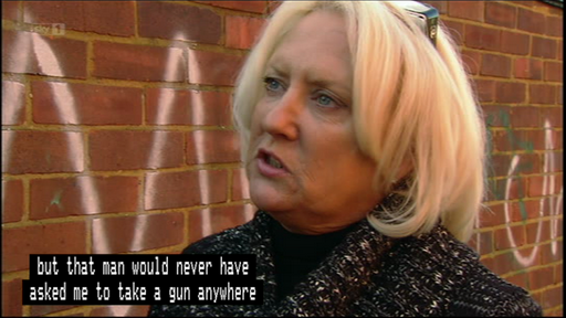

petgox Posted February 21, 2011 Posted February 21, 2011 Wow, I never knew VLC player supports teletext subtitles. I actually demuxed a file to get an srt subtitle so that I'd check if it works in VLC when I suddenly saw that you can directly select teletext subtitles in VLC, and the sync is perfect. This made my day, I don't necessarily need to watch the stuff in DVBViewer. Can you tell me what your recorded teletext subtitles look like in VLC player, when I play the recorded .ts file in VLC player(because of the known issues of synchronization in DVBViewer) and choose the subtitle track, it does show teletext subtitles (as you can see in the picture), I was wondering is there any way for these subtitles to be displayed not so narrowly but across the whole width of the picture, as it is displayed in DVBViewer. I tried changing few option in VLC, but unsuccessfully. Thanks in advance! Quote
