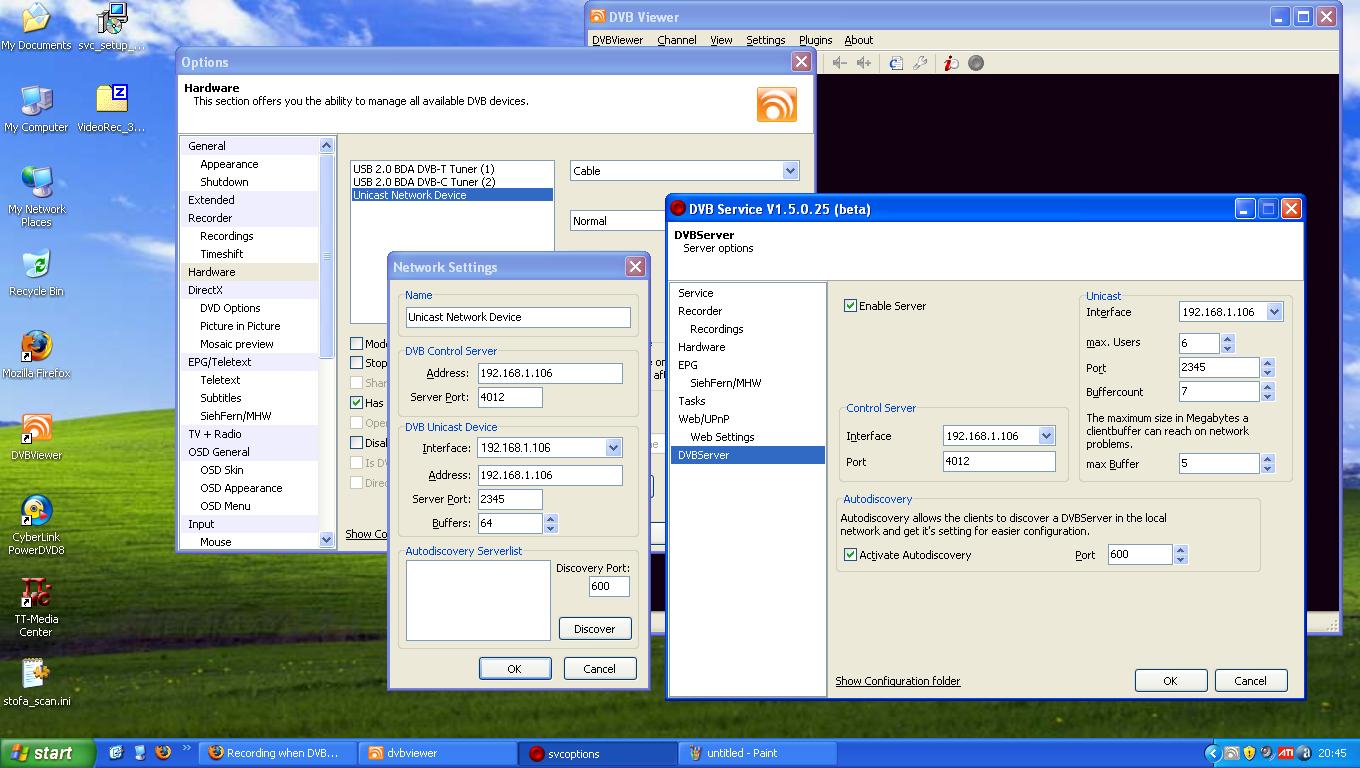

Thomas Fogh Posted July 29, 2009 Posted July 29, 2009 (edited) Hi, I followed the guide Recording Service and DVBViewer, but DVBViewer doesn't find any servers... (see picture) What could I be doing wrong? BR, Thomas Fogh EDIT: BTW, all I want is to record using the recording service, no streaming and the like. DVBViewer will not be running... so maybe I have misunderstood the necessity of the guide? How do I set it up to get the set recordings from DVBViewer, if possible? (or should I just use the WebInterface?) Edited July 29, 2009 by Thomas Fogh
Lars_MQ Posted July 29, 2009 Posted July 29, 2009 You can't discover, if the service configuration programm is active (the service is stopped then) and it seems you are using DVBViewer and service on the same PC so you NEED the streaming. The DVBViewer must be a slave of the service otherwise it is not possible to record in the background. The hardware device must be controlled by the service, there is no "sharing" of a device between defferent applications.
Thomas Fogh Posted July 29, 2009 Author Posted July 29, 2009 You can't discover, if the service configuration programm is active (the service is stopped then) Sorry, forgot to clarify. The service configuration is closed, when I try to autodiscover. It was just to show my configuration... it seems you are using DVBViewer and service on the same PC so you NEED the streaming. The DVBViewer must be a slave of the service otherwise it is not possible to record in the background. The hardware device must be controlled by the service, there is no "sharing" of a device between defferent applications. So if DVBViewer is never running when I'm recording, I don't need it? Thanks!
Lars_MQ Posted July 29, 2009 Posted July 29, 2009 If you only want to record with the service and program the recordings via the service webinterface, you don't need the DVBViewer on the server (well it must be installed but not configured).
