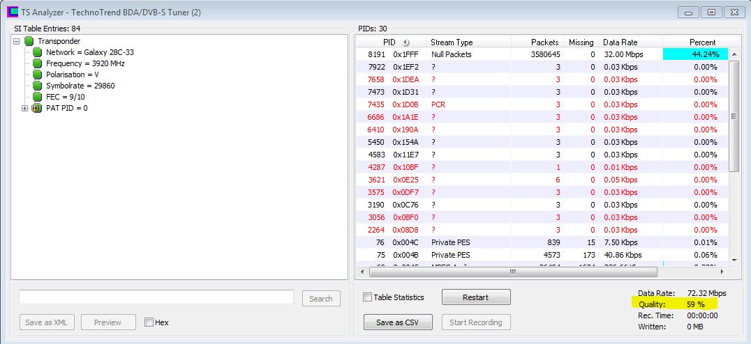

I use transedit all the time it is a great program and I like that it has a positioner to move my motor.
Would it be possible to include either quality or signal level to it in order to peak the dish?
Available in the Analyzer, plus a "missing packets" counter as indicator for the signal quality. This chapter describes how the Analyzer can be used in combination with the positioner console.

Do not use the analyzer too much so I had not noticed the Quality Indicator on it.
It is great information. I am including a jpg of the analyzer and where the Quality Indicator is located for others to see.
