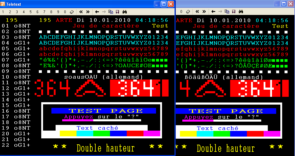

nars Posted December 16, 2009 Author Posted December 16, 2009 (edited) If this can help, here is a small ts stream (including teletext info) recorded from dvb-t: http://nars.aloj.net/temp/dvbt-teletext.ts and some screenshots showing the missing/correct characters: http://nars.aloj.net/temp/dvbt-teletext1.png http://nars.aloj.net/temp/dvbt-teletext2.png http://nars.aloj.net/temp/dvbt-teletext3.png http://nars.aloj.net/temp/dvbt-teletext4.png Not sure if this can help, and also it's possible that these are not all the possible Portuguese accented characters missing... but if you are willing to add support to these as a Portuguese setting in a next beta then I will later download it and do a more "intensive" check to find any other ones missing. Please let me know if you need something more. Thanks. Edited December 16, 2009 by nars Quote

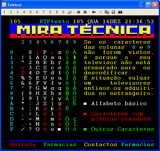

Griga Posted December 17, 2009 Posted December 17, 2009 Teletext page 105 is the most interesting in your ts sample. It's about the character set: - The white characters are from the Latin G0 Primary Set. - The red characters are from the Latin National Option Subset for Portugal/Spain So far it is covered by DVBViewer and the European teletext standard (as published by ETSI.org) - The green characters - don't know. Please tell me what is written on this page. Unfortunately I can't find anything about a Portuguese teletext character set it in the ETSI specifications. And without specifications it comes down to blind guessing and gets very time consuming... Quote
nars Posted December 17, 2009 Author Posted December 17, 2009 (edited) Unfortunately page 105 is not as interesting as you think, it should be indeed... but it is not because it doesn't include all accented characters... in fact it doesn't include any of the missing characters on DVBViewer, I did checked that on my standalone TV (where I can see all characters correctly in all pages) and DVBViewer with Spanish setting shows page 105 exactly like I can see it on standalone TV (yes, including the 3 blank ones on columns 8 and 9). Then this page is completely useless unfortunately and I guess the only way would be to create a Portuguese setting with base on the Spanish one and then search for the few missing characters in other pages and I'm willing to help on such task. Also note that there are no wrong characters at all with the Spanish setting (like with others), just a few ones missing but the ones that are shown are all correct, no swapped ones at all, that's why I say we could just use Spanish ones as base and then just add the ones missing to create the Portuguese setting. From what I did saw there are not much more accented chars missing other than the ones I did pointed on the screenshots, I may be missing one or two more rarely used but not much more... most accented non capitals are already ok with the Spanish setting, except for the ones with ~ and ^, on capital ones seems there are some more missing with ´ accent as well as I saw on the ones I did pointed. It's strange that there is no specification for such Portuguese accented characters as my standalone Thomson TV include a Portuguese setting that allows it to show all characters correctly. Also note that this problem is not specific to one tv channel but to all Portuguese channels. I would not bother too much maybe if this only affected teletext itself but it also affects subtitles through and it's very annoying to be reading them in realtime with missing characters Thanks. Edited December 17, 2009 by nars Quote
nars Posted December 17, 2009 Author Posted December 17, 2009 Btw, I have been searching on internet if I could find something related to the portuguese charset, I did found this document: http://www.ebu.ch/CMSimages/en/tec_doc_t32..._tcm6-10512.pdf there is a big list with many accented chars including the ones with tilde that are missing for me for example, not sure if this can be of any help for you... Quote

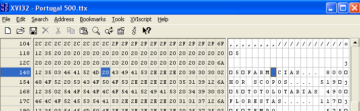

nars Posted December 17, 2009 Author Posted December 17, 2009 humm, I understand, in fact it was one of the first things I did, even before posting, was saving a teletext page but in txt and html (as I didn't knew what was .ttx format exactly) and looking at it in an hex editor, also found the 0x20's but thought there could be some filtering going in DVBViewer filtering "strange" characters and replacing them by 0x20, but now I guess that is not the case, and probably .ttx format is raw data from teletext, right? Thanks for all your attention Griga Quote
Griga Posted December 17, 2009 Posted December 17, 2009 but thought there could be some filtering going in DVBViewer filtering "strange" characters No. ttx is the output of the teletext decoder. It's up to the teletext renderer to decide how characters are displayed. There isn't much left for filtering anyway, because teletext is based on 7 bit character sets. One bit is used for odd/even parity checking (stripped by the decoder). Since teletext is a child of the analogue age, there is a lot of error protection, most of which is unnecessary in digital transmissions. Characters #0..#31 are control codes used for switching between different colors or states (e.g. block graphics mode on/off), #32...#127 are character codes. In text mode 13 of them may vary according to the language. And that brings me back to page 105 of your sample. The table contains character codes in the range of 0x80..0x9F (the green characters). They can not be transmitted as part of a normal teletext page. To me it looks like a list of replacement characters for Ã, Í etc. Replacing them by A, I etc. would not be correct, but more readable than just blanks. That is something DVBViewer could do. But where are these codes? Quote
nars Posted December 18, 2009 Author Posted December 18, 2009 (edited) And that brings me back to page 105 of your sample. The table contains character codes in the range of 0x80..0x9F (the green characters). They can not be transmitted as part of a normal teletext page. To me it looks like a list of replacement characters for Ã, Í etc. Replacing them by A, I etc. would not be correct, but more readable than just blanks. That is something DVBViewer could do. But where are these codes? humm, I understand, since it is 7bit then 7F would be the last char possible and not 9F, maybe they use some extra bit for that in some non-standard way or something? anyway my TV is rendering these green chars in page 105 exactly like DVBViewer, see: http://nars.aloj.net/temp/tt_dvbv_105.png http://nars.aloj.net/temp/tt_photo_105.jpg but the same tv is able to render accented chars (really accented and not 'õ' as 'o' for example) that are missing on DVBViewer on all other pages, see: http://nars.aloj.net/temp/tt_dvbv_100.png http://nars.aloj.net/temp/tt_photo_100.jpg Then how could my tv be using the "somehow special green chars" to show the "really accented" chars if it doesn't even show them "really accented" in the page 105? (hope you understand what I mean, my english is not very perfect as you probably already noticed ) Also check this, it's teletext available in the channel web site: http://www.rtp.pt/wportal/teletexto/index.php (on the input field below type 105 and click OK button) Curiously you will indeed see the green chars "really accented" here, but again if my TV doesn't show them like that in this page 105 then I guess it my be using some other way to render them as accented in the other pages. Edited December 18, 2009 by nars Quote
