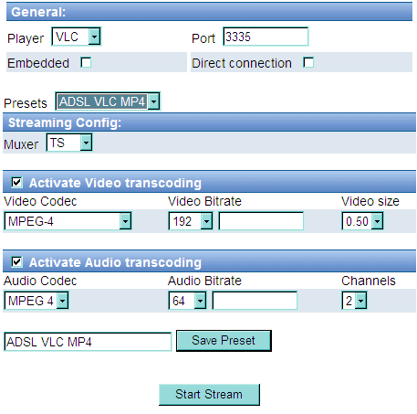

Gioxy Posted December 14, 2009 Posted December 14, 2009 64 ko/sec for video with transcoding and 16ko/Sec for audioSo a total 80Kb/s...??? ...but above all: what container/encoders are you using? Please try with the following setting (carefully set ALL them!) and tell us if they are working for you: Quote
richB Posted December 15, 2009 Author Posted December 15, 2009 So a total 80Kb/s...??? ...but above all: what container/encoders are you using? Please try with the following setting (carefully set ALL them!) and tell us if they are working for you: trancoding from mpeg2 to Mpeg4 will be very CPU consuming for my PC, I can only keep the mpeg2. I've been using wondow media encoder 9 for years and I've never has problems, using up to 800 kb/sec in mpeg2. Quote
Gioxy Posted December 15, 2009 Posted December 15, 2009 trancoding from mpeg2 to Mpeg4 will be very CPU consuming for my PC Are you really tested it? On my AMD 2400+ (a old 2MHz single proc) it took less than 30% CPU power (of course for SD TV...)Are you using the mandatory VLC version on you Recording Service PC (v. 0.8.6i)? I've been using wondow media encoder 9 for years and I've never has problems, using up to 800 kb/sec in mpeg2800Kb/s? ...less compression = less CPU consumption... Quote
