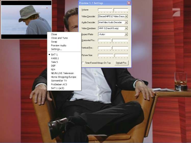

Griga Posted May 1, 2004 Posted May 1, 2004 (edited) I've just uploaded a new Preview Plugin to the Service Center, for all those who can't get enough... The Preview Plugin allows to open an additional Video Window and to watch two TV channels at the same time. However, both channels must be broadcasted on the same transponder (with the same frequency, in the same DVB data stream). So after having selected a channel in the DVBViewer, the selection of channels in the Plugin is limited accordingly. The Plugin is supposed to replace the according function in the DVBViewer (which only works with Marfi's source filter). It provides additional features, like switching to full screen mode and toggling audio between the Preview and the DVBViewer. Furthermore it is much more flexible, since it works with all source filters, and can be adapted to different circumstances, e.g. by selecting a suitable video decoder or video renderer in the Settings Window. Programming it was quite an interesting task, since running two DirectShow filtergraphs in one application causes several problems. They where finally solved by streaming audio/video from the plugin to a separate program (with an own memory space), by using the Shared Memory feature ('Memory Mapped Files') of Windows. Everything else can be read in the ReadMe file (English and German provided). So, download and enjoy! Griga Edited August 7, 2005 by Griga Quote
ginacman Posted May 3, 2004 Posted May 3, 2004 Hello, very nice plugin. I've just noted that, when previewing audio, if the Audio Decoder is set to <Auto>, preview switch just works once: audio toggling is apparently stopped then. Setting the Audio Decoder to whatever not <Auto> (i.e Moonligh Odio Dekoda) suffices to "fix" this behaviour. I've tried also to mess up with the filter merits, artificially increasing one filter or another, but no change then. Thank you for any explanation. - Quote

Griga Posted May 3, 2004 Author Posted May 3, 2004 if the Audio Decoder is set to <Auto>, preview switch just works once: audio toggling is apparently stopped then. You can try to find out what is going on by right-clicking the Settings Window - a Context menu appears that lists all filters in the graph (can be used to open the property page of a filter, if it provides one). Or even better: Use GraphEdit (Connect To Remote Graph). The graph with the Video/Audiodump filters is the DVBViewer's, the other one belongs to the Preview. so, it is possible to have a PiP P.P. that open more than one preview window Technically yes. Programming a kind of stream manager that handles multiple channels and sends them to different EXE's would be quite laborious, however. To be true: I don't think that it makes much sense - the number of channels that are worth watching on a specific transponder is quite limited anyway. IMO not worth the effort. Quote

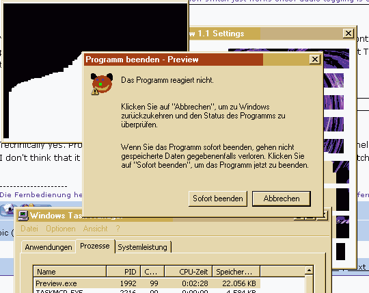

Klausing Posted May 4, 2004 Posted May 4, 2004 I have the same problem with the Auto settings. Maybe we have the same problem I have no chance to find out wich decoder the programm use if i set to Auto. Conecct to remote graph don't work. I see only the graph of the DVBViewer. Then i must kill the DVBViewer by Taskmanager and the preview is still open and must killed separately. (remember my mail) If i set the right decoder i have no problem. Steffen Quote

ginacman Posted May 4, 2004 Posted May 4, 2004 (edited) I have the same problem with the Auto settings. Maybe we have the same problem I have no chance to find out wich decoder the programm use if i set to Auto. Conecct to remote graph don't work. I see only the graph of the DVBViewer. Then i must kill the DVBViewer by Taskmanager and the preview is still open and must killed separately. (remember my mail) If i set the right decoder i have no problem. Steffen Hello. After using GraphEdit, I was about to report just the same feedback. GraphEdit, when freshly started, shows two graphs to choose. Soon after, or possibly when doing the first audio switch, one of the two graphs becomes unavailable. Also, most of the times, GraphEdit dies or becomes unresponsive. Rebuilding the graphs temporarily recovers the audio function, until it becomes lost again at the next action. Also, if set to a named filter as opposed to <auto>, the GraphEdit shows the same problems, instability and graph not shown, but in that case audio prewiewing is preserved across switching. My ignorance is great, but it looks like the dynamic ability to build the second graph is hindered somehow. Choosing a specific filter sticks the plugin to use it altogether, beyond further unexptected behaviours. Sorry for my rude explanation. Thank you. Edited May 4, 2004 by ginacman Quote

Klausing Posted May 4, 2004 Posted May 4, 2004 @ Griga is there a way to render the graph directly in graphedit? I tryed to connect to the remote graph. After that I removed the AudioDecoder and would render the AudioPin of the Demuxer, but i couldn't do this. It was not possible in Graphedit.. So i can't say which decoder here is the problem... steffen Quote
ginacman Posted May 4, 2004 Posted May 4, 2004 (edited) In fact it wouldn't seem to be a severe problem at all. If one sticks to a given audio filter, and Moonlight Odio looks a very good one, the plugin is absolutely ok as is. On the other hand, if somebody else does not experience the problem, it would probably means to me that something has got peacefully unscrewed anywhere inside the operating subsystem, although I must say I've never tinkered with it, just kept it up to date with patches and no significant gltches. Thank you Edited May 4, 2004 by ginacman Quote
Griga Posted May 4, 2004 Author Posted May 4, 2004 is there a way to render the graph directly in graphedit? No, because you can't create and configure demuxer output pins in GraphEdit. Quote
