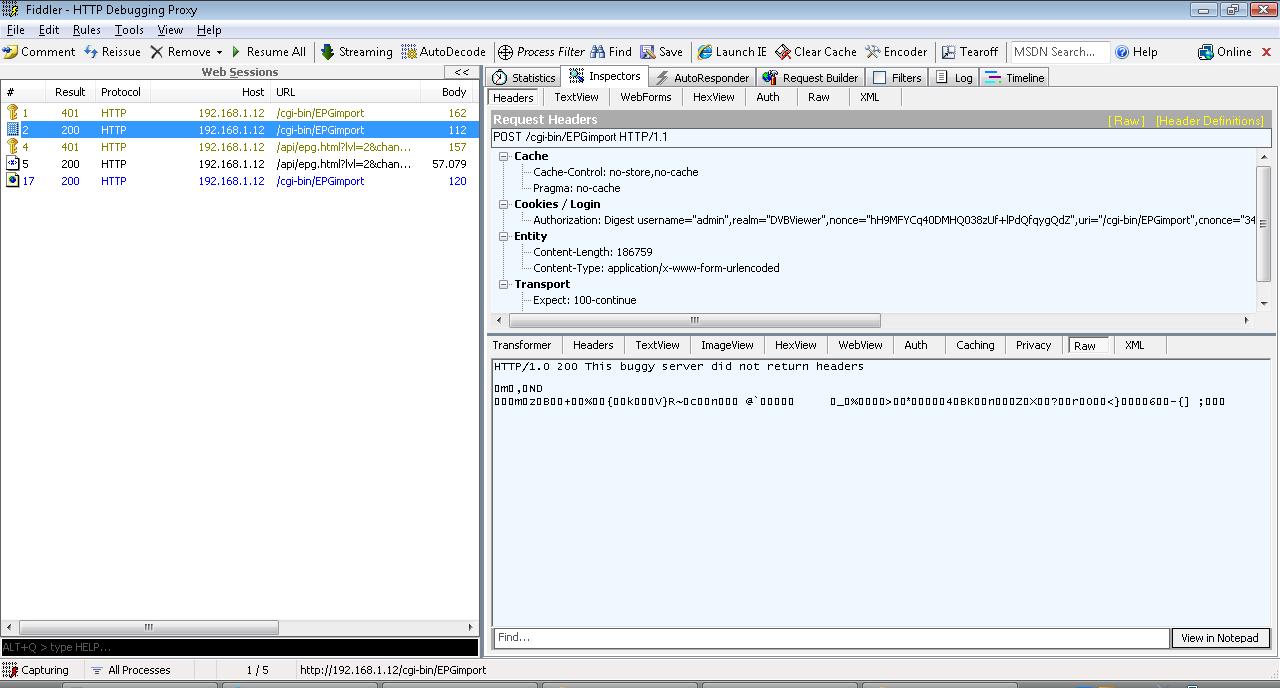

imho RS does not properly handle EPG uploads while using HTTP AUTH.
Seems like it never returns 200 or what-so-ever-code after the initial 401.

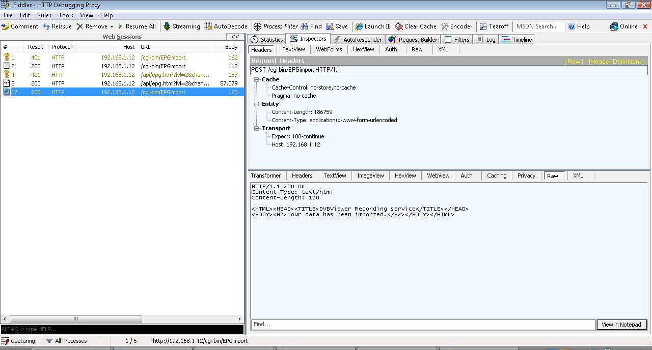

1) usual request w/o auth:
2) request with auth:
The "200" reply is deceptive as it is forced by Fiddler after a (300ms) timeout.
Maybe I got something wrong ... any thoughts appreciated.

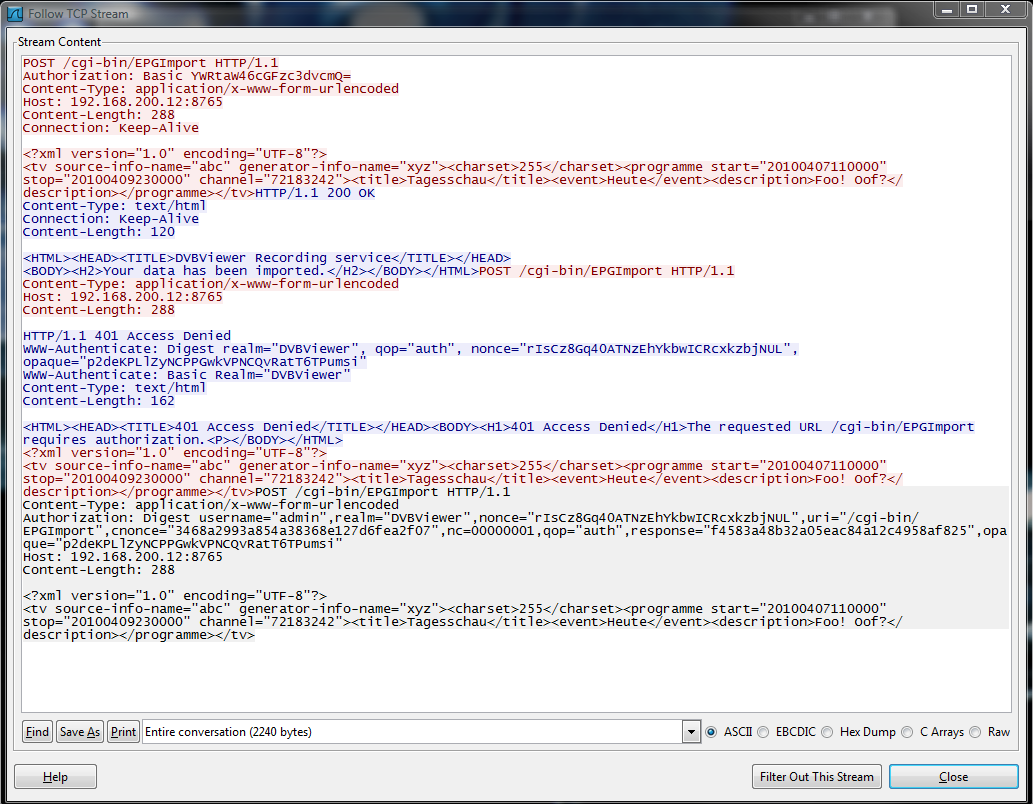

For the books, wireshark:
My best guess is: you 401' right after the headers but don't discard the chunk-junk and (so) miss the last gray request which finally timeouts the socket.
