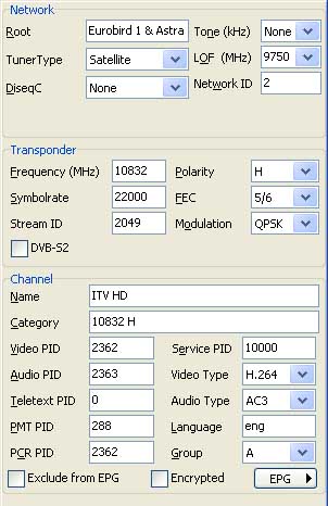

Can't seem to tune ITV HD now 16th May 2010. I have scanned with on 10832 with no luck, tried King of sat settings, no luck ;)
Using Technisat card with 4.2.1 on XP32bit.
Anyone offer any suggestions?

Working here, Service PID 10000, VPID 2362, APID 2363, PMT 288, PCR 2362, Stream ID 2049, Symbolrate 22000, FEC 5/6.
Heres a grab of my settings, is there a silly mistake anywhere?
I have a skystar 2HD BBC HD fine ITV HD on old frequency was fine too.
Regards
Regards
The settings look right, have you tried deleting all the channels off that transponder and scanning again?
What about a quick scan with TransEdit to make sure you can pick it up?
I don't have any other channels on that transponder :-(
Quick scan says no channels!
Yep its got me :bye:
