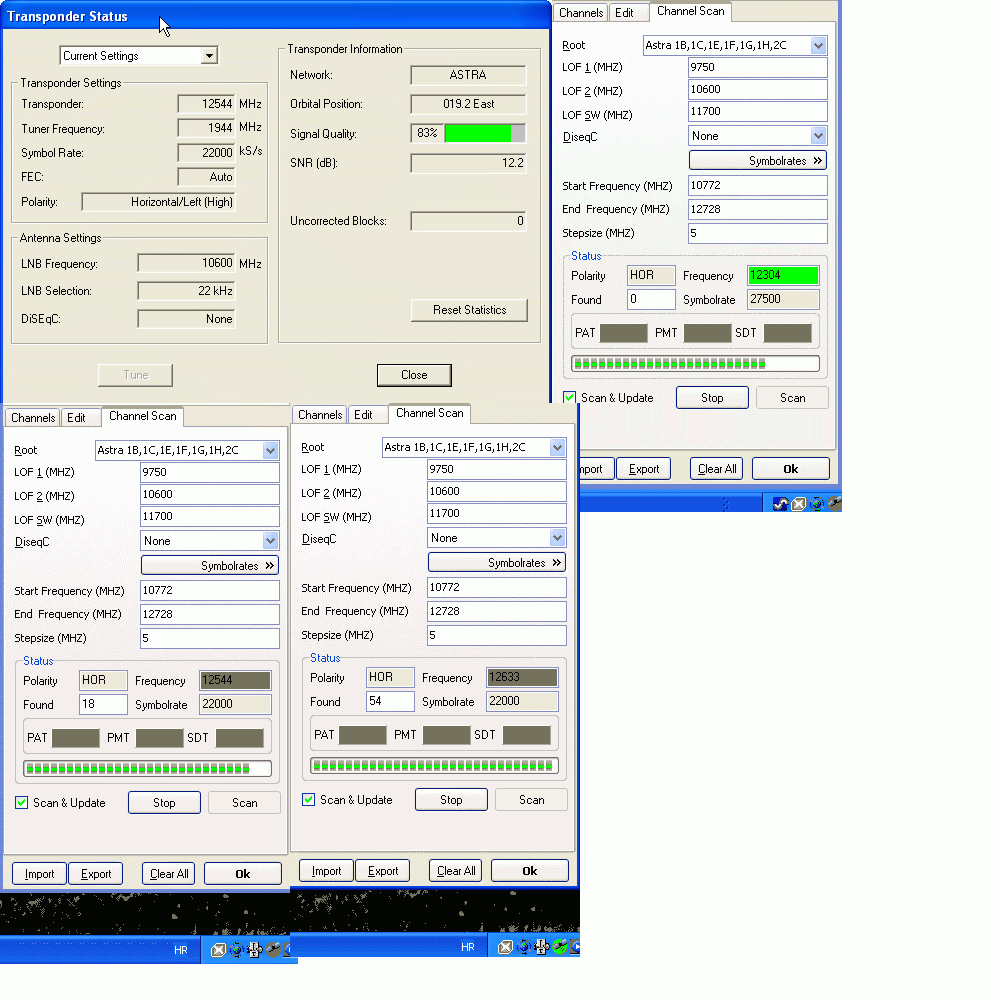

On Astra 19.2 before i could get about 800 channels under the house roof(28% of signal strenght), but now when its on better place and with clear line to sky i get only 50 channels.
On my analog reciver i get all the possible channels but they all replaced they places(??).
On this position I get about 80-85% of signal strenght.

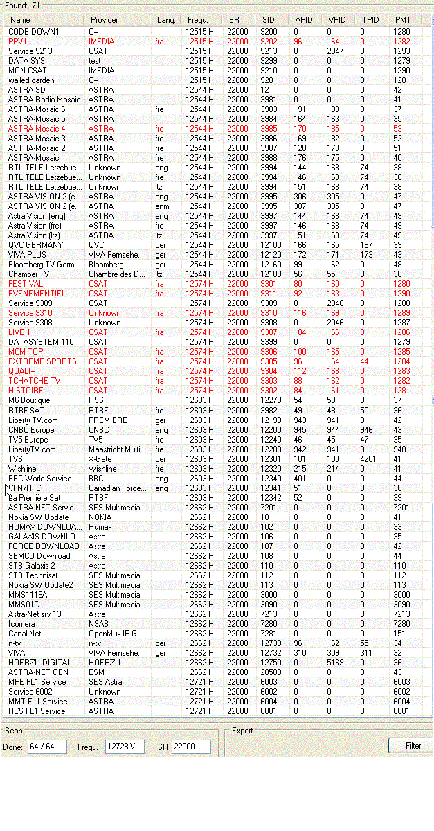

The right click to the setup4pc : most of the "athp-filiago-sat@once....." are getting signal but others not.
Only on > 12500 Mhz at the transponders 48 to 62 i get this 50 channels.
Mybe the dish vertical angle is wrong?
What should i do?

Well, installing and adjusting a LNB/dish for digital reception is much more tricky than for analog reception. Was it some kind of Do-It-Yourself action? Then I'd ask a specialist to look after it. Without appropriate measuring instruments it's hard to get good results...
Yes it was [some kind of Do-It-Yourself action]. OK I will ask a specialist to look after it. But everything worked fine in the first case.

I have captured this from transedit scan, and thats the only thing I get, but if I move satellite dish few mm +/- i get few channels more or less.
