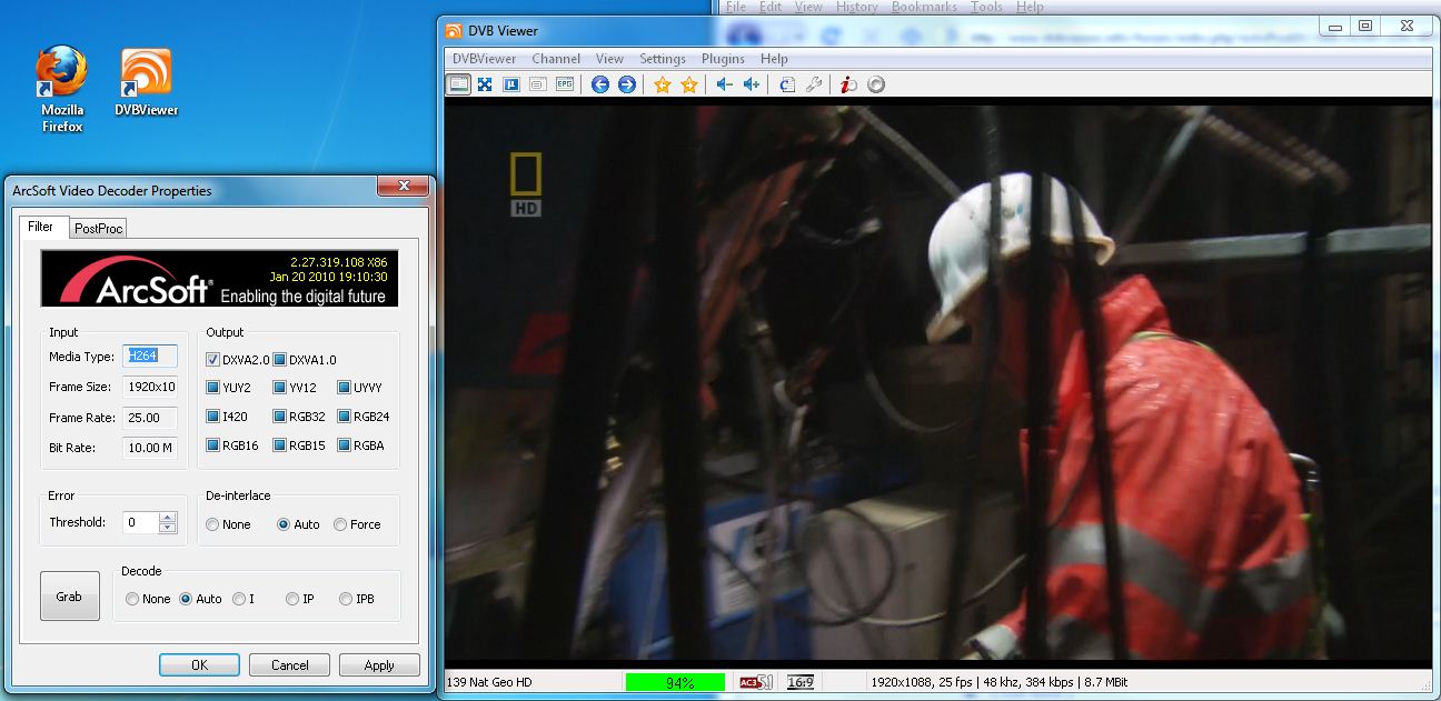

bogdan1980 Posted May 28, 2010 Posted May 28, 2010 this is not good for hd in any app, DVBViewer, progdvb, etc. Deinterlace is crap with DivX. Better than this is Arcsoft, Microsoft.( these 2 are the only ones that work ok for me on HD) with an terratec cinergy htc xs hd tuner. Elecard, Mainconcept has same problem with deinterlace on HD material or mpeg2. Cyberlink any version has problem with HD, some channels freeze or squares and artifacts appear. fddshow is not working for live-tv. Quote

bogdan1980 Posted May 31, 2010 Posted May 31, 2010 http://www.DVBViewer.info/forum/index.php?...15&start=15 on latest post are my arcsoft pack.... DivX has problem with fast moving action, like sports, etc. Framerate are low with divx as well. Microsoft is good on HD, but has some deinterlace problem on mpeg2 on some digital sd channels. That's why i use Arcsoft for mpeg2 and Microsoft for HD. Or Arcsoft for both mpeg2 and HD. Quote

bogdan1980 Posted June 7, 2010 Posted June 7, 2010 It seems that Divx HD codec has some option in Control Panel. But for that you need to install all Divx setup, go to Program Files/Divx, and look for Control Panel exe. Change here Hardware acc and so. Now is working ok. Quote
bogdan1980 Posted June 7, 2010 Posted June 7, 2010 Edit : I have an monster CPU, an Quad 4 Ghz. Arcsoft is Dxva 1 and Dxva 2.0. What i just notice, after few minutes of live-tv on HD with DVBViewer and Arcsoft image freeze. Same with Cyberlink ( any version of hd codec). Live-tv is ok , no freezing, with Divx and Microsoft. Maybe DVBViewer is not optimised for Arcsoft and Cyberlink. Or maybe my nvidia drivers are crap. Quote
