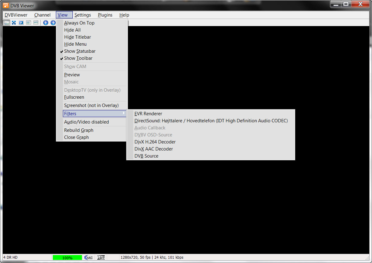

TGM Posted May 25, 2010 Author Posted May 25, 2010 ->Griga: I tried to remove the tick in "Use DVBViewer Filter for TS/M2TS", then record a new sample from the HD channel, and then play it in MS Mediaplayer, but still no sound :-( I have attached a screenshoot of my current settings under View->Filters ->Derrick: If I understand your post correctly, then I can confirm that the TS files plays perfectly inside e.g. TSPlayer, just not inside MS Mediaplayer. Quote
Derrick Posted May 25, 2010 Posted May 25, 2010 I never use MS Mediaplayer This is about DVBViewer. Otherwise: ..and I guess the Windows Mediaplayer uses a demultiplexer/splitter that isn't able to detect that type of audio. The DVBViewer Filter (DVBSource) knows how to deal with it, but it's only available for our products. Quote
Griga Posted May 25, 2010 Posted May 25, 2010 Griga: I tried to remove the tick in "Use DVBViewer Filter for TS/M2TS", then record a new sample from the HD channel, and then play it in MS Mediaplayer, but still no sound :-( You were supposed to play it in DVBViewer with this setting unticked, in order to find out if you encounter the same problem as in WMP. Of course the DVBViewer settings have no influence on WMP. That's just a test. Quote
