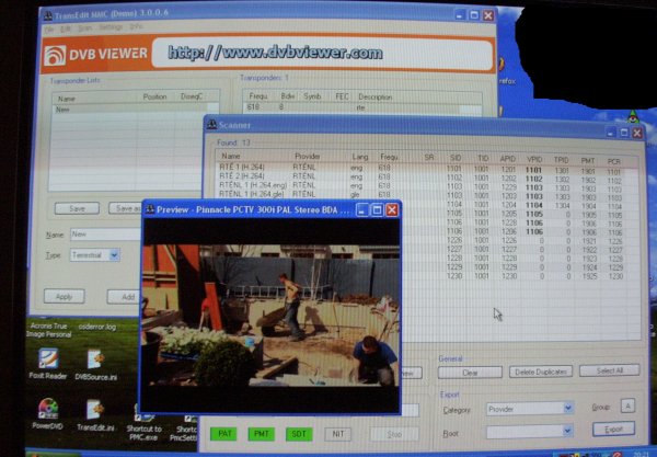

I was given an old Pinnacle 300i hybrid card a few months ago, in the hope it might be capable of decoding the Irish DTV setup.

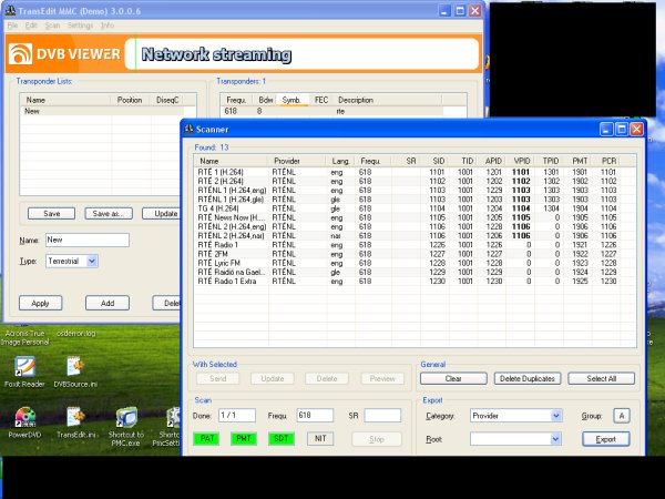

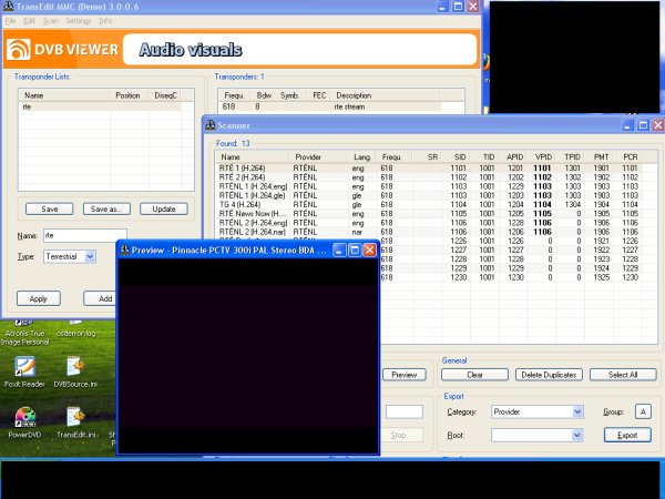

After a lot of messing around with no results on the digital tuner I recalled I had a Transedit demo sitting on my hard drive, so pointed it at the card.
I was amazed the Preview came up with a working picture and sound in a window and even better it could go full screen. CPU load was only 40% and there was no stuttering or breakup at all.
The Irish system is H.264 and mpeg4
What I really need to know now - if I purchase DVBViewer Pro, will it take the settings from Transedit and function properly with no further CPU load? This is an old PC - an Athlon 3000 with 1GB memory. I suppose the saving grace of the Irish DTV is they're not doing HD yet, else I'd have no chance of it with this machine.
I attach some screenshots...

Thanks for the reply, Griga.
I should have mentioned that ffdshow h.264 was already on there and Transedit pulled it up automatically, which was great.
The video card is an nvidia FX5600XT with hardware accel enabled, but whether the decoder was making use of it, I don't know.
The results are encouraging, as I didn't think this 300i was going to work and was near to giving up on it, but the bare specs of the 300i hardware led me to think it should work.
I shall buy DVBV, to make full use of it.
