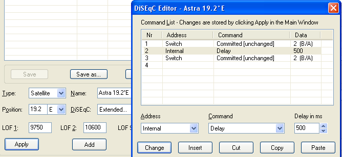

Griga Posted August 8, 2010 Posted August 8, 2010 I would first try to let TransEdit send the B/A command for Astra 19.2° East twice with a delay in between (see screenshot). Select DiSEqC = Extended, enter the commands, click Apply and scan... Quote
leecovuk Posted August 8, 2010 Author Posted August 8, 2010 (edited) Thanks Griga, I do appreciate your help. However still no change or luck. I've also just discovered something called 'DVBLink TVSource' and a 'Preview' of it but that seems unable to drive my device properly either. The list of software which fails to properly handle my DiSEqC is now DVBViewer, ProgDVB, DVBLink TVSource Preview, Media Portal and Windows Media Center. This really is driving me towards insanity. Obviously I need to wait to hear from Hauppauge support, but what is your gut feeling regarding only WinTV being able to properly control the DiSEqC? Have I unfortunately purchased an evil non-compatible device? Might there be a power supply or hardware fault? Annoyingly, I probably have no right to compain to Hauppauge seeing as WinTV can happily do its stuff. WinTV however is next to useless for me, as my usage will simply be too tedious in WinTV. I really hope it's me who's doing something wrong, but I fear not. Here's hoping for a miracle! Lee UK Edited August 8, 2010 by leecovuk Quote
