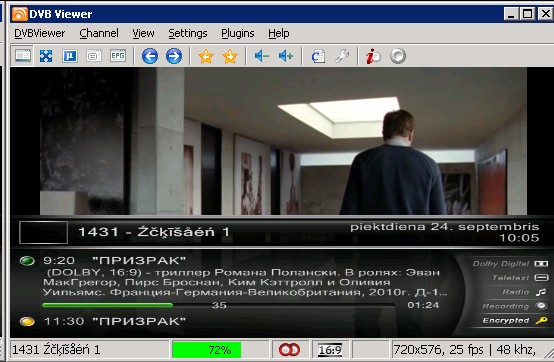

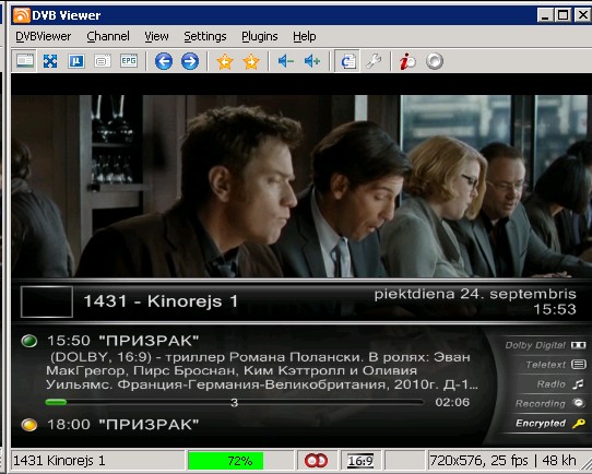

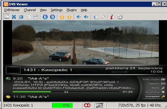

Problem: Can't see correct cyrillic channel names ( 36E HTB+ )
If i launch DVBViewer with applocale and set locale to russian then channel names are ok but epg is broken.
Pics:
Normal launch - EPG correct, Channel names wrong - http://3priedez.net/images/uploads/img.2010.09.24.Oqtg7L.jpg
From Applocale with forced cyrrilic locale - EPG wrong, Channel names ok - http://3priedez.net/images/uploads/img.2010.09.24.YWY4On.jpg
DVBViewer 4.5 RC1 ( the same problem was with 4.3.1.177 )
Windows 7 x64
System locale: Latvian
channellist - http://3priedez.net/files/channels.dat

i checked channels.dat format - channel names are not stored as unicode chars. so for now i made small software to transliterate russian channel names to ascii un write back channels.dat .
i hope DVBViewer will get full unicode support someday.
transliterated channel sample - http://3priedez.net/images/uploads/img.2010.09.24.kdcRHL.jpg
