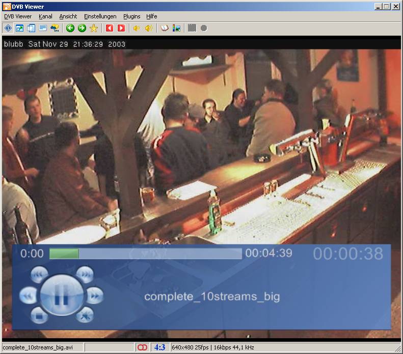

Well the Screenshot was made in the DVBViewer V2.0 in combination with the OSD Skin Plugin. If you are talented you are also able to port the skin into the current 3.1 version. Anyhow it is a bit trickey, since 3.0 offers sooooooo (really i could not add that much "o" to come up to the version) many OSD features :)
