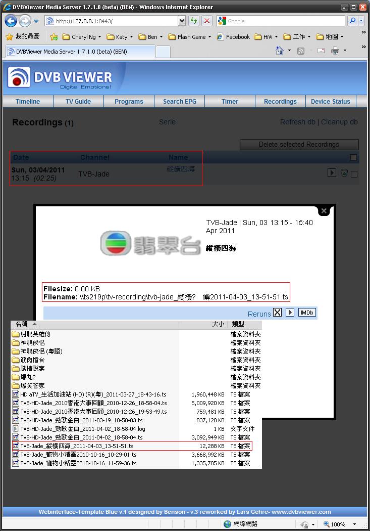

hk_ben Posted April 3, 2011 Posted April 3, 2011 I've installed RS 1.7.1 and it works great but with some minor unicode issue. Under recordings tab, the recordings showed properly but the file name isn't in unicode. It is not able to determine file size and also perform streaming. This apply to all browser that I used (FF, Chrome, IE8) and also iphone UI. In fact, this happens from earlier version and I'm not sure this even works well before or not. Other than this issue, everything that RS works like a charm. Regards support.zip
Lars_MQ Posted April 10, 2011 Posted April 10, 2011 I tried to reproduce it and couldn't find any problem. Does this happen with all the recordings?

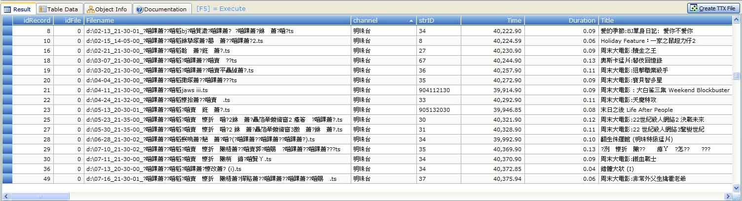

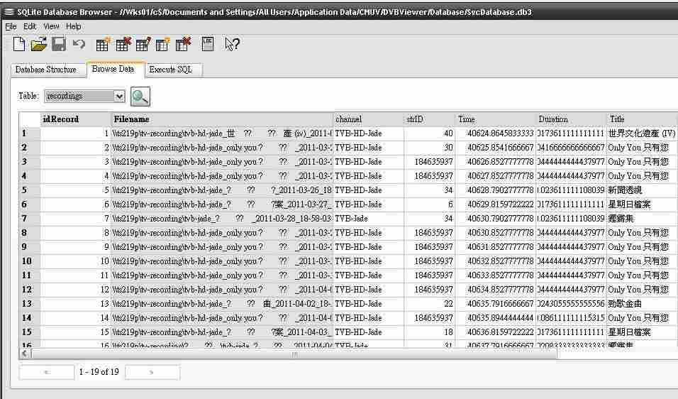

hk_ben Posted April 11, 2011 Author Posted April 11, 2011 (edited) Tried update the Database manual. Recording tab can showed the file correctly. The following field are showing garbage. Field "Filename" under table "recordings" in SvcDatabe.db3 Field "Filename" under table "mediadb" in MediaDatabase.db3 Field "Filename" under table "recordings" in TVDatabase.db3 Field "Filename" under table "Video" in Svcmedia.db3 Unicode problem in the database ?? Edited April 11, 2011 by hk_ben
Lars_MQ Posted April 11, 2011 Posted April 11, 2011 no more likely some other problem, otherwise we would have more reports than yours. But I have no clue what the problem with your system might be...

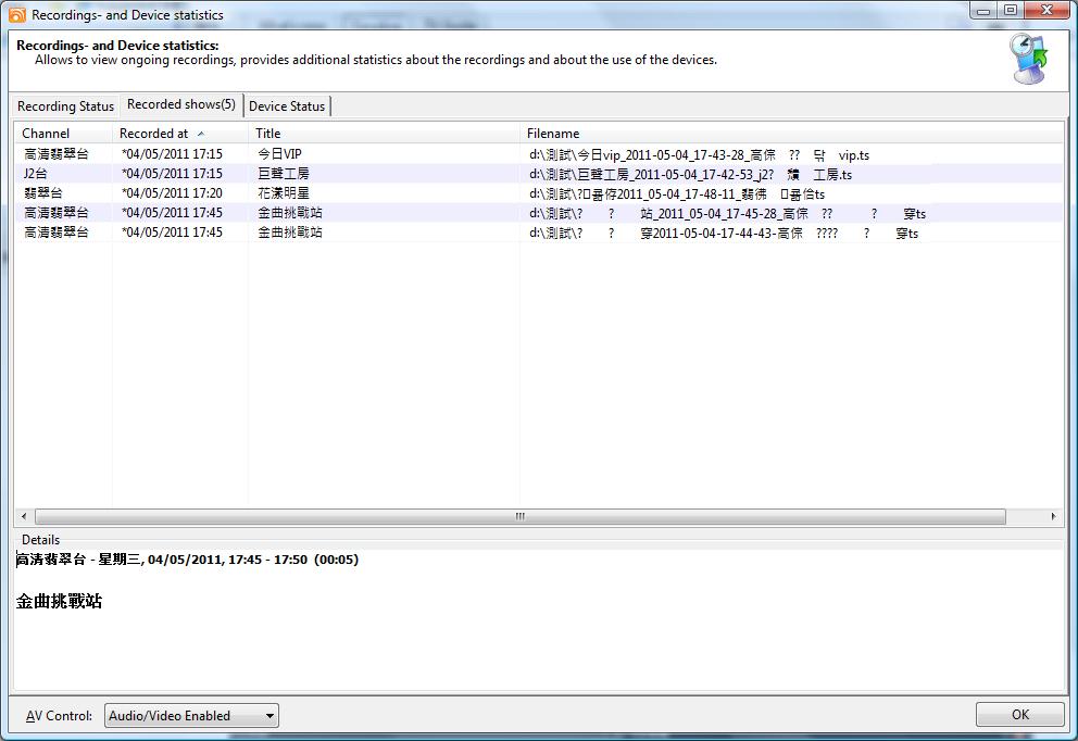

cwchan3618 Posted May 4, 2011 Posted May 4, 2011 (edited) http://www.DVBViewer.tv/forum/topic/36447-DVBViewer-43xx-beta/page__st__686 nope, those problems were solved. Only the first problem was solved. The second problem wasn't. The second problem still exists in 4.8.0.0. The second problem is very similar to Ben's. The filename field in the database table was wrong. I guess the string function used to concatenate the fields cause the problem. Edited May 4, 2011 by cwchan3618
cwchan3618 Posted May 4, 2011 Posted May 4, 2011 (edited) I further experiment with the "File naming scheme". I tried "%event_%year_%date_%time_%station_%event", and "%event-%year-%date-%time-%station-%event". For sample 1-4, the %event expand to different value when placed at the begin and end of the file name. For sample 4 and 5, by using "-" instead of "_" as separator, the file name was different. Hope this can help you figure out the problem. Edited May 4, 2011 by cwchan3618
Lars_MQ Posted May 4, 2011 Posted May 4, 2011 You did it in the DVBViewer or in the recording service? cause the screenshot is a DVBViewer window.
cwchan3618 Posted May 4, 2011 Posted May 4, 2011 You did it in the DVBViewer or in the recording service? cause the screenshot is a DVBViewer window. I did it in DVBViewer.
Lars_MQ Posted May 4, 2011 Posted May 4, 2011 what does the filenames look like in the windows explorer? do they also have wrong chars?

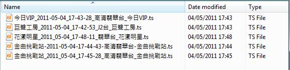

cwchan3618 Posted May 4, 2011 Posted May 4, 2011 (edited) what does the filenames look like in the windows explorer? do they also have wrong chars? In Windows Explorer, the file name displayed correctly. I think you may need the Chinese character for testing. Here are the filename in characters: 今日VIP_2011-05-04_17-43-28_高清翡翠台_今日VIP.ts 巨聲工房_2011-05-04_17-42-53_J2台_巨聲工房.ts 花漾明星_2011_05-04_17-48-11_翡翠台_花漾明星.ts 金曲挑戰站-2011-05-04-17-44-43-高清翡翠台-金曲挑戰站.ts 金曲挑戰站_2011_05-04_17-45-28_高清翡翠台_金曲挑戰站.ts Edited May 4, 2011 by cwchan3618
Lars_MQ Posted May 4, 2011 Posted May 4, 2011 First of all I want to thank you for your patience and help. Could you please zip and upload the TVDatabase.db3? It's strange that all other entries are correct encoded, the filename of the file is correct only the entry of the filename in the db seems to be messed up. What happens if you move the recordings to another folder, clean up and refresh the recordings db (-> options -> recordings) which will remove the entries from the db and then move the files back into the recordings folder and do a cleanup/refresh again?
cwchan3618 Posted May 4, 2011 Posted May 4, 2011 First of all I want to thank you for your patience and help. Could you please zip and upload the TVDatabase.db3? It's strange that all other entries are correct encoded, the filename of the file is correct only the entry of the filename in the db seems to be messed up. Zipped file attached. What happens if you move the recordings to another folder, clean up and refresh the recordings db (-> options -> recordings) which will remove the entries from the db and then move the files back into the recordings folder and do a cleanup/refresh again? I cannot do the experiment at the moment because some recording is in progress. I'll let you know the result later. Actually, I created a new subfolder called "測試" before I tried the five entries before. TVDatabase.zip
Lars_MQ Posted May 4, 2011 Posted May 4, 2011 ok, I think I found the problem. There was a "hidden" conversion of an UTF-8 encoded widestring to ansistring, where only ansistring should have been used. The problem exists in the recording service and the DVBViewer. You don't need to perfom the move files test anymore. Thank you again for your help. And also a thank you @hk_ben, this was a really deeply hidden bug, sorry I didn't find it sooner...

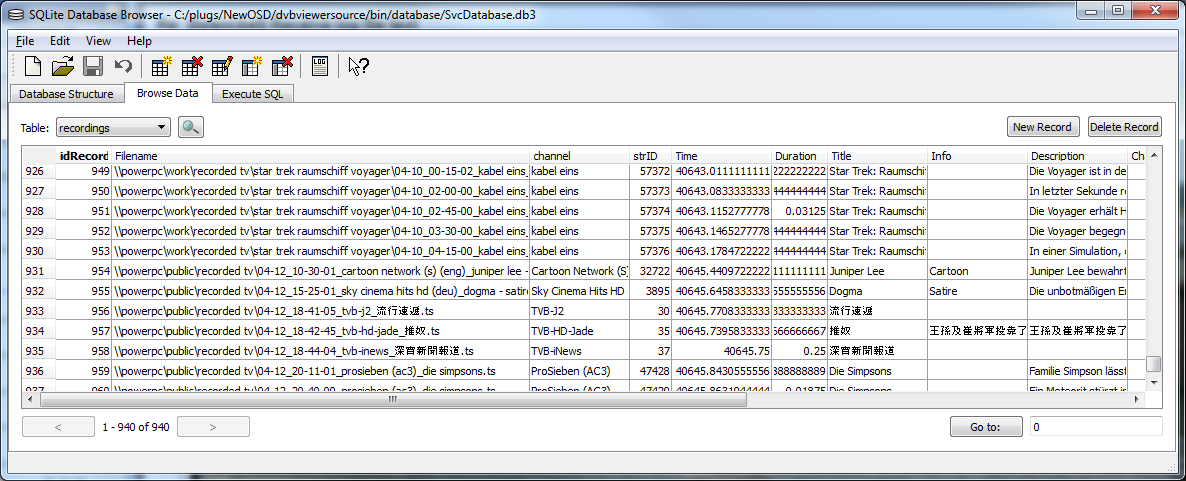

hk_ben Posted May 24, 2011 Author Posted May 24, 2011 (edited) RS 1.8 solved most of the issue. But still some invalid character in svcmedia.db3, table 'video' field Filename. Edited May 24, 2011 by hk_ben
hk_ben Posted May 24, 2011 Author Posted May 24, 2011 (edited) Tried delete the entire svcmedia.db3 and recorded a short clip...still invalid character, only for this field. However, what's this db's field used for, the RS WebGUI looks good so far. Edited May 24, 2011 by hk_ben
Lars_MQ Posted May 24, 2011 Posted May 24, 2011 Does it only happen if you record the files or also if you empty and refresh the database?
hk_ben Posted May 24, 2011 Author Posted May 24, 2011 (edited) Tried empty the database using the DB browser or refresh it using 'Update Medias library DB' via RS WebGUI, same result. Edited May 24, 2011 by hk_ben
