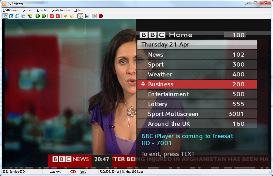

uglyned Posted April 20, 2011 Author Posted April 20, 2011 Also, when tuned to a channel that has MHEG stream, not many normal OSD functions seem to work. OSD menu brings up MHEG text, not OSD menu. OSD OK, up down etc don't do anything. Some channels have 2 different MHEG entry points - 'text' - teletext equivalent, then the 'red button' that brings up a more context sensitive menu. At the moment, both 'OSD Menu' and 'Red button' seem to do the same thing. Or crash. Quote

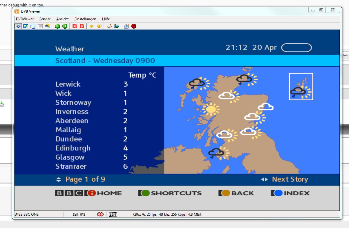

uglyned Posted April 20, 2011 Author Posted April 20, 2011 Just a bit more on the video freezing. It seems to happen when the MHEG app fills the full screen, with no opacity. Most MHEG screens fill some of the page and you can see some of the original video still playing in the background. Some, like the full weather maps on BBC, remove all background video and the full screen is taken up with the MHEG screen, and no opacity. In these cases, when I return to the video by exiting MHEG, the video is frozen. Changechannel / rebuild graph works OK, so nothing serious goes wrong. Quote
hackbart Posted April 20, 2011 Posted April 20, 2011 The behaviour is correct, if the Mheg Application takes over command, the remote actions are sent to the application. If the key has been accepted the OSD wont receive the command. All regular STB's act in the same way, and i did not found a solution to handle the regular OSD and the Mheg5 Display in the same time. Do you have a page on BBC which causes this behaviour? You might try to open this page, when the DVBViewer is in debug mode (-debug) Christian Quote
uglyned Posted April 20, 2011 Author Posted April 20, 2011 Weather - weather maps then choose a reguin. Or 7001 - the iPleyer information page. But will send another debug with it on too. Quote
hackbart Posted April 20, 2011 Posted April 20, 2011 You mean something like this? I only have a few outdated streams here, but it works like it should. Can you provide a ts dump of it (could be done via Transedit)? Christian Quote

uglyned Posted April 20, 2011 Author Posted April 20, 2011 You mean something like this? I only have a few outdated streams here, but it works like it should. Can you provide a ts dump of it (could be done via Transedit)? Christian That screenshot is from DVB-T. I can't even get DVB-T to load at the moment - crash straight away. The crashes were on DVB-S BBC 1 and BBC 2. Attached debug.log - started DVBViewer, went to BBC2 (Satellite), loaded MHEG, saw some screens, exit MHEG. Then went to change channel and crash. Now getting crashes just when changing channel to / from MHEG - not even when trying to load MHEG. Quote

mr_chaela Posted April 21, 2011 Posted April 21, 2011 Just a little more on this. If you do ever have any ideas about how to keep MHEG in the background on an MHEG enabled channel so that regular OSD commands still work it would really help with usability. Something like teletext - let the user know there is an MHEG stream there, but don't engage it until they press the relevant button. If it's not possible, never mind. One workaround I found, if I'm on an MHEG enabled channel and I put the guide on then off, that disables MHEG. I can't re-engage MHEG til I change channel but at least I have OSD control back. (PS This might be a bug but please don't fix it!) I was about to ask if it were possible to temporarily disable mheg. This workaround works fine. Please don't get rid of this 'feature'. btw. mheg is working fine on my win7 x64 system. Quote
uglyned Posted April 22, 2011 Author Posted April 22, 2011 Video scaling I'm not sure that video scaling is working properly. On DVB-S, if I open MHEC and select news, MHEG goes full scren and a small window appears on the left which is like a window on a full screen video. If DVBViewer is running in windowed mode, or in full screen after being windowed (ie after double click), the video scales properly. But if I open DVBViewer in D3D exclusive, the video does not scale. I tried in non-D3D exclusive full screen, but video was a bit jerky when MHEG was present. Quote
