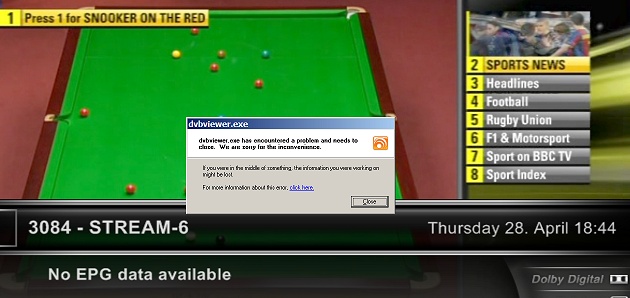

mobiwan Posted April 28, 2011 Posted April 28, 2011 I expected "multiscreen" to not work at all... Actually it finds the correct hidden video stream when you arrow to Sport Multiscreen or type in 3001 and press enter Then it "crashes" (though video is running till you click dialog) support.zip Quote

hackbart Posted April 29, 2011 Posted April 29, 2011 Okay, the last crash message seem to be somewhere outside the DVBViewer. You might start the DVBViewer in Debug mode (with parameter -debug) and try to provoke the crash. If it is caused by the mheg engine you will see inside the debug.log the last action which has been executed before the crash appears. @xtonys: If you have licensed the Mheg-Plugin and installed it you will be able to start the mheg teletext everywhere it is sent. The behaviour is similar to the Mheg5 capable STB's. Pressing the Red button should open the menu for instance. Christian Quote

mobiwan Posted April 29, 2011 Posted April 29, 2011 Okay, the last crash message seem to be somewhere outside the DVBViewer. You might start the DVBViewer in Debug mode (with parameter -debug) and try to provoke the crash. If it is caused by the mheg engine you will see inside the debug.log the last action which has been executed before the crash appears. I will try it. I suspect it's something to do with switching transponder/channel to the Sport Multiscreen as 3001 or Sport Multiscreen menu is only time the crash happens, and it always happens. So may be something outside of MHEG5 that MHEG5 invokes. On Triax 537 setbox which is MHEG5 for DTT and Satellite but not a Freesat box, the Irish & UK MHEG5 work, but not Freesat Multiscreen applications in MHEG5. http://www.boards.ie/vbulletin/showthread.php?t=2056168690&page=6 It has failed certification for Saorview, though they hope to have it sorted soon. Quote
mobiwan Posted April 29, 2011 Posted April 29, 2011 (edited) Selected BBC1 NI hit ESC to load MHEG arrow to sport Multiscreen on menu (entering 3001 has same effect) hit enter key Stream 6 (the sport Multiscreen start screen) video plays and application displays EPG Now/next info, then crashes as above. Last lines of log are 29.04.11 12:10:39.406 MHEG5Host_DisplayVideoAt 0 0 720 576 0 029.04.11 12:10:39.437 MHEG5Host_UpdateScreen 362 310 320 72 29.04.11 12:10:40.312 Mheg CMHEG5Video::CMHEG5Video 101 paint (playing) 29.04.11 12:10:40.312 MHEG5Host_DisplayVideoAt 0 0 720 576 0 0 29.04.11 12:10:40.328 MHEG5Host_UpdateScreen 368 505 200 30 29.04.11 12:10:40.328 MHEG5Host_GetServiceIndex dvb://0002..1ae6 29.04.11 12:10:40.328 MHEG5Host_ApplicationUnavailable 29.04.11 12:10:40.328 Mheg TIn: keep running: FALSE 29.04.11 12:10:40.328 MHEG5Host_TuneToService 3084 29.04.11 12:10:40.328 MHEG5Host_SetDECFC 1 29.04.11 12:10:40.328 MHEG5Host_SetWSS 0 29.04.11 12:10:40.328 MHEG5Host_SetAudioVolume 100 29.04.11 12:10:40.421 Settuner Start 29.04.11 12:10:40.421 TfrmMain Allocate TechnoTrend BDA/DVB-S Tuner (2) 29.04.11 12:10:40.421 Settuner Found usable hardware 29.04.11 12:10:40.421 TfrmMain Release TechnoTrend BDA/DVB-S Tuner (2) 29.04.11 12:10:40.421 TDVBHardware.SetTuner PMT: 262 - SID: 6886 - Freq: 12441 - Type: 1 29.04.11 12:10:40.421 TBDADevice Settuner 29.04.11 12:10:40.421 DeviceSendDiSEqCCommand bvTechnoTrend 29.04.11 12:10:40.812 TBDACITTModuleSingle CI Base SetTuner Entering 29.04.11 12:10:40.812 TBDACITTModuleSingle CI Base SetTuner Leaving 29.04.11 12:10:40.812 Settuner End 29.04.11 12:10:41.140 TBDACITTModuleSingle WinProc Received PMT ready 29.04.11 12:10:41.140 AddAVCodecs VCodec: CyberLink Video/SP Decoder (PDVD7), ACodec: CyberLink Audio Decoder (PDVD7) 29.04.11 12:10:41.218 VCodec CyberLink Video/SP Decoder (PDVD7) 29.04.11 12:10:41.218 ACodec CyberLink Audio Decoder (PDVD7) 29.04.11 12:10:41.250 vmr9 The operation completed successfully 29.04.11 12:10:41.250 VMR9 Go YUV 29.04.11 12:10:41.250 AddVideoRenderer Add VMR 9 29.04.11 12:10:41.328 VMR9 Flags: 29.04.11 12:10:41.328 VMR9 OffscreenSurface 29.04.11 12:10:41.328 VMR9 RGBDynamicSwitch 29.04.11 12:10:41.328 VMR9 768 x 576, count: 1, minbuffers: 1 29.04.11 12:10:41.328 VMR9 Format: 842094158 - Pool: 0 29.04.11 12:10:41.328 VMR9 Native Size 768 x 576 29.04.11 12:10:41.328 VMR9 Result offscreentexture: NV12 29.04.11 12:10:41.375 Used Filter 0: VMR 9 Renderer (Custom) 29.04.11 12:10:41.375 Used Filter 1: Default DirectSound Device 29.04.11 12:10:41.375 Used Filter 2: CyberLink Audio Decoder (PDVD7) 29.04.11 12:10:41.375 Used Filter 3: CyberLink Video/SP Decoder (PDVD7) 29.04.11 12:10:41.375 Used Filter 4: DVB Source 29.04.11 12:10:41.828 MHEG5Host_CREATE Use Resolution 720x576x32bpp 29.04.11 12:10:41.828 Mheg MHEG5_ProcessPMT for 0002.07F6.1AE6 (MHEG Carousel active: 1) Complete file debug.log Previous attempt Windows log file 998a_appcompat.txt (Gets same error every time) here is "support tool" results support.zip Disabling the 2nd tuner makes no difference. Tuner1 1st DVBS2 S3200 PCI card. Connected to 16 port Multiswitch (28E, 19E, 13E & 9E) Tuner2 2nd DVBS2 S3200 PCI card. Connected to 16 port Multiswitch (28E, 19E, 13E & 9E) Tuner3 & Tuner4 Single Mobi DTV USB DTT dual tuner stick. Irish Terrestrial TV Edited April 29, 2011 by mobiwan Quote
