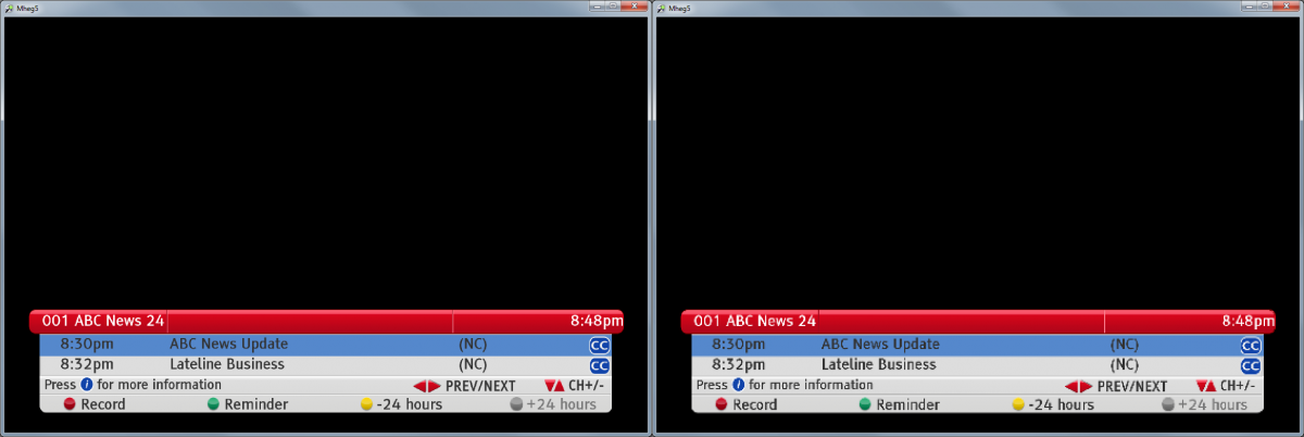

This was a mean one, because the Mheg Application calls a "Stop Video" in order to display the channel logo. Since this is an i-frame and regular stb's only decode either tv stream, or i-frames a stop should close the video decoding process. In case of the DVBViewer the stop forced a stopped graph.
The next update will fix this problem.

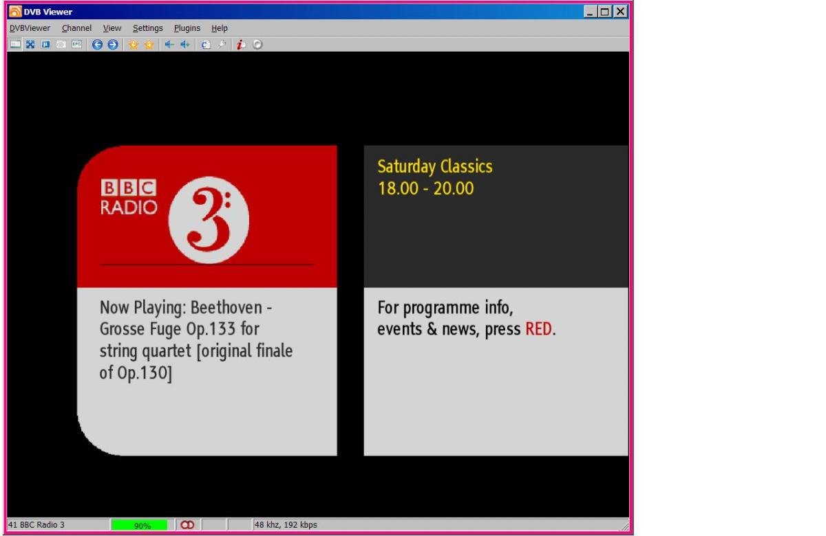

This topic got hijacked by people who wanted to talk about something else. The problem that concerns me, and groovyclam, is covered by postings #1 to #9.
I have just installed DVBViewer 5.2 and the new MHEG-5 module, and the problem is still there. It only affects DVB-T, and I can understand why it hasn't been fixed because Christian has no access to direct UK DVB-T.
Fortunately, there's a work-around, and that's why I had not persued the matter. However, the work-around has changed. Before 5.2, if I got the second (wrong) screen from the first posting, I could press escape, it would switch to BBC 1 and, after a short pause, I could select a channel again. Now 5.2 crashes when I press escape - dvbviwer cannot continue - please tell Microsoft about this problem.
It seems to have got worse, not better.

:) Well the Mheg Plugin uses a simple but fast software based pixel scaler which causes this problem. From the technical point of view the plugin scales all images which are designed for 720x576 PAL resolutions in Mheg (only the Australians use a higher resolution) up to 1280x720 and the DVBViewer scales the image to the current resolution. These lines are caused by the software scaler, but it definitively looks more awful if the plugin does not resize the images to 1280x720 pixels.
There are some pages with a lot of text which do look much more significant:

I have now tried DVBViewer 5.2.8 and the new version of MHEG-5 that was issued with it.
The main problem which is the subject of this thread of messaging is still there. The minor problem, the black line on some MHEG-5 screens, has gone.
There is another problem, which may not have been properly reported. You will see from message #3 in this sequence that I had reported :-
"In other BBC MHEG displays there is often a video insert, as there should be, and it is a scaled down version of the full screen picture on the channel being watched, as it should be. However, after skipping from one MHEG item to another a few times, for example reading the news headlines, the video insert is no longer scaled, just a fragment of the full-screen picture. That is wrong."
In the current implementation the video insert is now always a fragment of the full-screen picture and never a scaled-down image. Unlike the other problems, which only happens on DVB-T, this happens on DVB-S too.
I hope this information helps.
