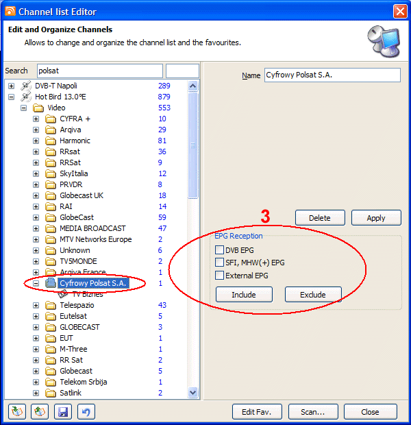

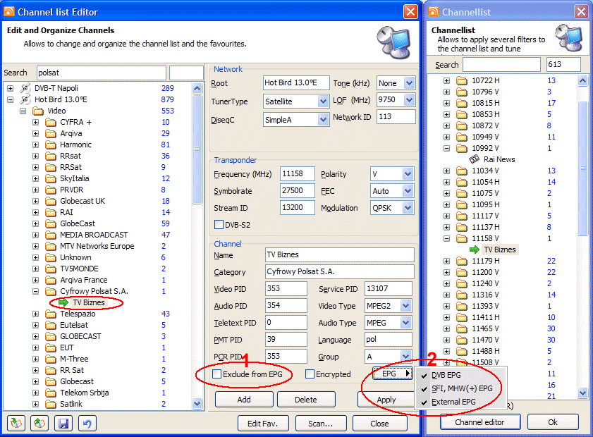

Gioxy 7 Posted May 1, 2011 Share Posted May 1, 2011 Hello pataczek amd wellcome aboard... You can manage EPG reception in the "Channel List Editor", where you can easily exclude (or include only for a specify type...) a single channel (see 1 & 2 on first image) or a whole transponder (see 3 on 2nd image): Quote Link to post

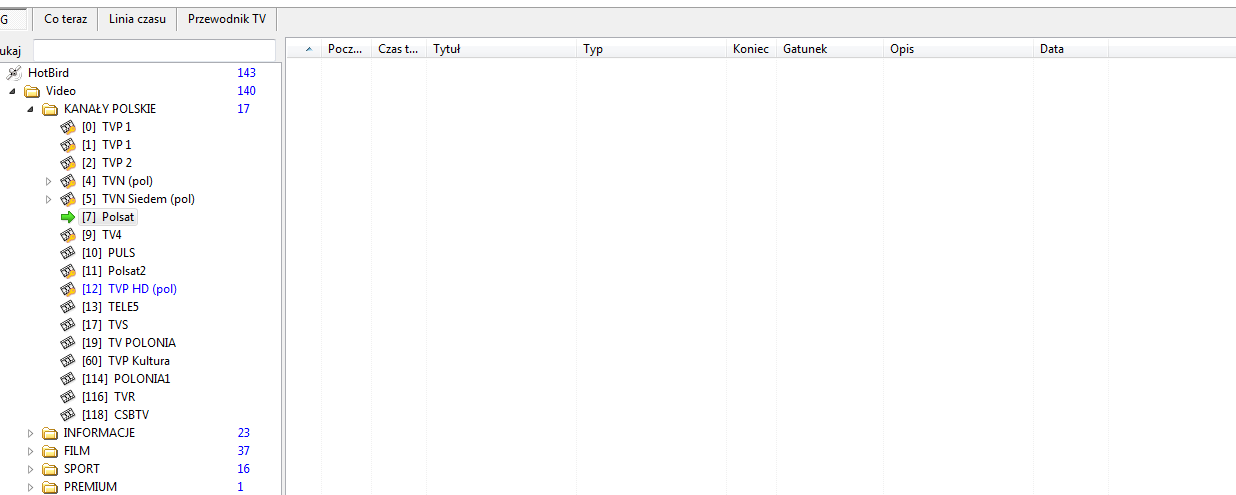

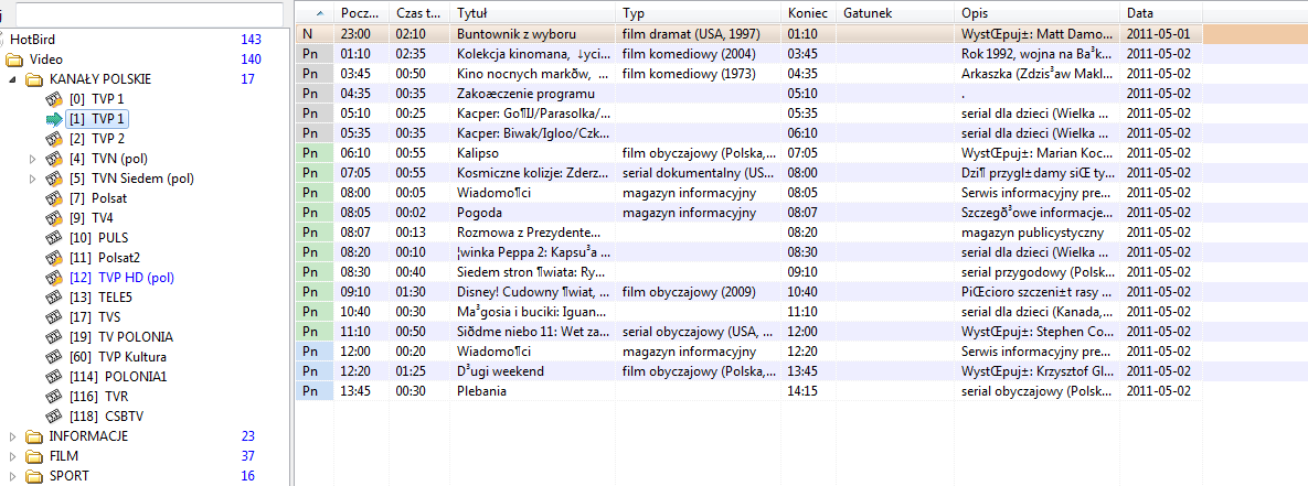

pataczek 0 Posted May 1, 2011 Author Share Posted May 1, 2011 (edited) Oh God! I've always thought it's used to select what type of EPG will be used for channels DVBViewer is definitely more powerful than a man could thought. I feel so dumb now EDIT: Unfortunately I was right. I deselected all EPG options on Polsat, deleted epg.dat and then started DVBViewer on Polsat. No EPG on Polsat and errored on TVP1. Edited May 1, 2011 by pataczek Quote Link to post
Gioxy 7 Posted May 2, 2011 Share Posted May 2, 2011 (edited) No EPG on Polsat and errored on TVP1As also you noted before, some trasponder carry EPG info of channels not inside itself; so, if your clues are right, ie the wrong EPG data is that on 11158V, you can try to "sacrifice" this entire trasponder EPG reception with the third method exposed up: select that trasponder, check (at least) "DVB EPG" and then press "Exclude" *AND* "Apply" button ... Hope this can solve Edited May 2, 2011 by Gioxy Quote Link to post
pataczek 0 Posted May 2, 2011 Author Share Posted May 2, 2011 I've done it in your way. It results in no EPG on channels from 11158V. However, when I tune to it, DVBViewer still grabs EPG for other channels on other frequencies (incl. Cyfra ones). Additionaly, when I tune to other frequencies, it doesn't grab EPG for channels from 11158V. Seems there's an inaccuracy in description of this function. Quote Link to post
