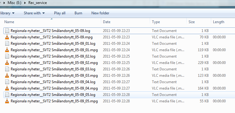

Are you sure? I just tryed the same thing with a free channel with the same result. Here are the logg file:
SVT2 Smålandsnytt 2011-05-09
E:\Rec_service\Regionala nyheter__SVT2 Smålandsnytt_05-09.mpg
Device: FireDTV BDA Tuner DVBT
22:23:37 / 00:00:00 (~ 0,0 MB) Start
22:23:38 / 00:00:00 (~ 0,1 MB) PID 1029: MPEG2 Video, 16:9, 720x576, 25 fps
22:23:38 / 00:00:00 (~ 0,1 MB) PID 1028: MPEG Audio Stereo, 48 khz, 192 kbps
22:23:39 / 00:00:01 (~ 0,1 MB) Errors: 1
22:24:40 / 00:01:03 (~ 0,1 MB) Stop
Average Data Rate: 0,001 MB/s
Total Size: 0,1 MB (70864 Bytes)
I also included a picture of my recording map.
