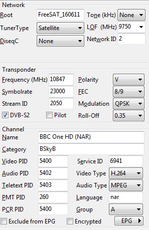

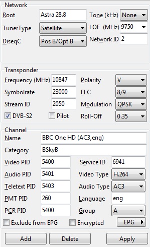

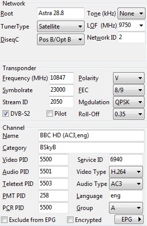

I think I also had problems "adding" the channels - eventually, I just modified the original settings manually.
Here are my settings if they are of any use.
post-65222-0-66589900-1308336105_thumb.jpg post-65222-0-23452600-1308336099_thumb.jpg
some of the values on that picture are wrong..
Download file from KingofSat and rescan
The only difference that I can see is that you are using the stereo narration channel, but I am using the 5.1 audio track.
That was only to show as one of the channels, I normally use the AC3 channel on AUDIO PID 5401 for BBC One HD (AC3,eng)
