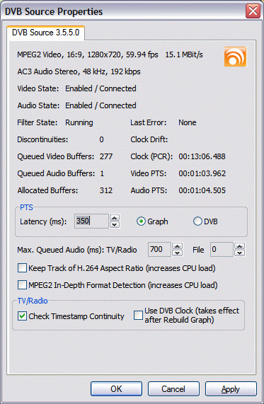

Griga Posted October 11, 2011 Posted October 11, 2011 I do not have subtitles Terra Nova.mpg Have you already tried recording as TS? DVBViewer says AC3 2.0 the whole time What does the DVBViewer Filter property page say? Quote
antdude Posted October 11, 2011 Author Posted October 11, 2011 (edited) Have you already tried recording as TS? What does the DVBViewer Filter property page say? No, I have not tried TS format. After messing with it, I think I figured out what's wrong. It seems like I had to pick the other audio track ("AC3 Audio Stereo (2)" instead of "AC3 Audio Stereo (1)". Weird. I wonder why 5.1 wasn't on the first one. I have not fixed the closed captions/subtitles part yet. CCExtractor GUI v0.59 does see them and I was able to extract. I attached a screen shot of DVB Source properties when using default audio track #1. Edited October 11, 2011 by antdude Quote

Griga Posted October 11, 2011 Posted October 11, 2011 My understanding is that .mpg doesn't record subtitles ATSC closed captions are part of the video data (in the MPEG2 user_data section), so they are recorded for sure in MPG files. However, as European software DVBViewer doesn't seem to take this into account, because DVB subtitles are located in a separate stream that can only be recorded as TS. @antdude: What are your settings for MPG playback? Is the DVBViewer Filter enabled for MPG playback in the DirectX options? If not, what is listed under View -> Filters when a MPG file (not being in progress) is played? AFAIK DVBViewer doesn't contain native support for ATSC closed captions in MPG files (only for TS), so I guess some third party DirectShow filter is looking after it. However, when it comes to playing ongoing recordings, DVBViewer forces DVBViewer Filter usage, because many other source resp. splitter filters are not able to open files in shared mode (one instance writing, another one reading). That would explain the missing subtitles in ongoing recordings. Quote

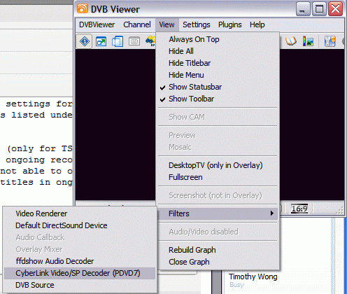

antdude Posted October 11, 2011 Author Posted October 11, 2011 ... @antdude: What are your settings for MPG playback? Is the DVBViewer Filter enabled for MPG playback in the DirectX options? If not, what is listed under View -> Filters when a MPG file (not being in progress) is played? AFAIK DVBViewer doesn't contain native support for ATSC closed captions in MPG files (only for TS), so I guess some third party DirectShow filter is looking after it. However, when it comes to playing ongoing recordings, DVBViewer forces DVBViewer Filter usage, because many other source resp. splitter filters are not able to open files in shared mode (one instance writing, another one reading). That would explain the missing subtitles in ongoing recordings. Yes, DVBViewer Filter is enabled for .MPG and .TS. I attached a screen shot of the Filters with the same recorded .MPG file. Quote

Griga Posted October 11, 2011 Posted October 11, 2011 I did use DVBV for playback on recordings (in progress and finished). Last hope gone... anyway, the VLC media player is able to play DVBViewer MPG recordings in progress and to display ATSC closed captions in MPG files (just tried). That would be a solution for your problem (not for mine ). Quote
