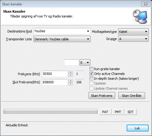

My cabel-TV provider: YouSee has recently changed some channels and told me to change the NETWORK-ID from 120 to 100.
I don't know, where to do that, and every time I scan for channels, I get the message: post-117970-0-72352800-1322846895_thumb.gif No hardware available!

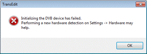

I have also scanned the transponder with TransEdit 3.8.2.0. The result: post-117970-0-69575500-1322848074_thumb.gif

While you're waiting for a genius, my comment would be that those messages usually mean some other application has control of the tuner, or else the device is disabled.
Network ID can be changed in Channel Editor, but you would have to do it for each channel. They might Auto-update anyway if you have that option selected. Nothing you can do until you get the hardware working.

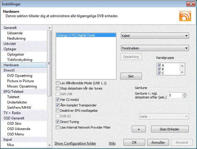

You are probably right about the control of the tuner. I have had DVBViewer Recording Service installed and deleted again in my many attempts to make it work.
Now I installed Recording Service again, and Unicast Network Device actually scans for channels, but finds 0 programs and 0 frequencies. That is, I think, due to the wrong Network-ID.
I have tried Channel Editor, and it is maybe simpel, but I can't make it work.
Where can I find a tutorial/manual for Channel Editor? or is there no such one?
Which file is the source file?
I have got it to work. It had nothing to do with the Network-ID, but something must have taken control over the tuner.
I brought windows 7 back to a system image from september and then everything worked again. Great!
