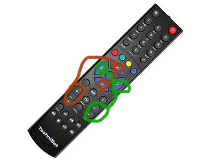

I have SkyStar USB2 HD and use its remote control. I modified this remote control from the settings in DVBViewer. I want to use osd up as channel up at the same time, and also osd right as volume up. Is it possible ?
Red buttons are up-down, and greens are left-right. And why these buttons have same functions?
The buttons are sending a identical signal.
So you should use osd-up/osd-down. Than it should work.
one more thing; osd-up/osd-down just show the channel name and i must push ok to change channel. i want to change channel directly, not also use ok button. thank you.
