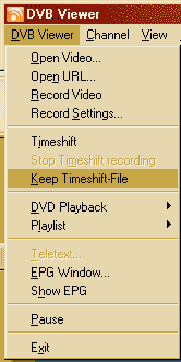

But you can keep the timeshift data if you want. Only enable it in DVBViewer menu.

I understand you right! And if you want to keep this file you have to activated what i wrote. Otherwise the timeshiftfile would deleted after using by DVBViewer.

after a little bit of menu surfing i noticed that this feature is already implemented under record->stop timeshift recording.
