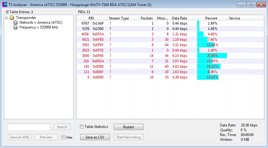

Hello i installed windows 7 and transedit now i can't scan or analyze none of the atsc signals i press analiyze but it give me 0% signal and a lot of pids with errors i think transedit scan it as cable QAM insted of atsc and if i change use standard interface and choice atsc then i get the initializing the dvb device has failed error :/ is theres any chance to fix this? i would really appreaciated

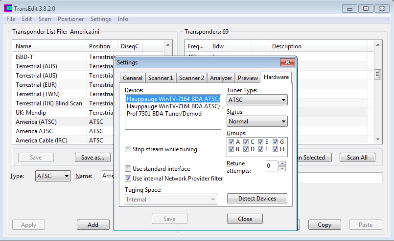

What is the detected tuner type in the hardware settings?
Im using the 3.8.2 and when i had windows xp i used the 3.6.0 and atsc channels works perfect, i already installed the 3.6.0 here on w7 but i got the same error, transedit showed as atsc/qam, i notice that DVBViewer won't scan channels too if i leave out the use internal network filter option dvbviwer says theres no device if i choice, it detects the card but scan 0 channels :(
There are two Hauppauge entries in the hardware list. A dual tuner card, I guess. What about the second tuner? Set the first one to "Don't use" if you want to try.
Please also try the "Use standard interface" option, and attach the file TransEdit.ini here (located in the configuration folder, see Info Menu in TransEdit). It will tell me more than screenshots.
Yes is a dual tuner i set one as normal and the other don't use and dosen't work i got the same, if i choice use standard interface then i got the error "Initializing the dvb device has failed" when i used xp i set "standard interface" and tuning space: atsc but it won't work here, i attach the ini file hope that helps! =)

According to the TransEdit.ini content everything is ok. Does it work with the Hauppauge application or Windows Mediacenter?
yeah i can watch all channels on windows media center and i can scan them on tsreader as well too :/
