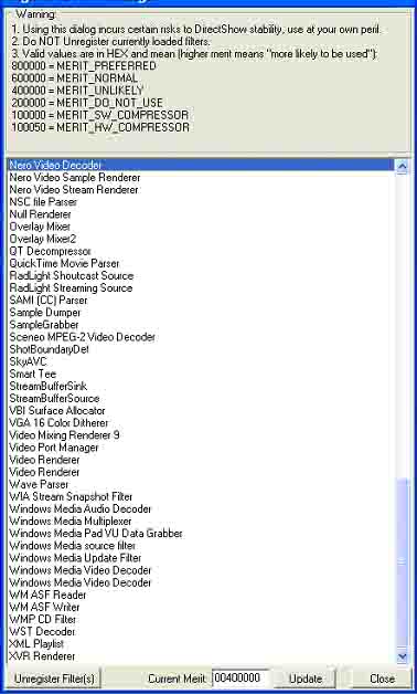

I used the ZoomPlayer to unregister the filters you mentioned above (Frauenhofer AV & Nero digital audio) as I didn't have the Radlight Filter Manager you mentioned. There are plenty of filters left now (pls. see attached image) -- do I need them all?
I'm using mainly the Intervideo A/V filters with the DVBViewer.
Thanks for your help m8!
Henk

The filters look fairly ok. I can't see any nasty things there - mostly the MS stuff that comes with DirectX, though I don't know what's in the upper part.
Anyway - I think the freezing problem is not related to DirectShow filters. Seems to be rather a conflict between the SkyStar2 and the modem. I experienced something similar with a dial up modem some time ago - no freezing, but the SkyStar2 was stopped for some moments when the modem connected, thus spoiling ongoing recordings. It vanished after changing to a DSL USB modem.
So, have a look at the Windows device manager. See wether any conflicts are displayed there. Disable all communication protocols for the SkyStar2 by un-ticking the checkboxes in the properties - you'll only need them for INet via satellite. Maybe it does something...

I found the Radlight Filter Manager and the help pages were very helpful.
(Yes, I do speak German. Do they exist in English -- if not I help with a translation of'm as I found them extemely helpful) -- Especially the part about the registry settings for intervideo and DVDexpress filters so that they would use hardware acceleration. It seems I have much less CPU usage now (@15% when before it was > 30%)
