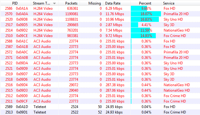

I have a SkyStar USB2 HD CI and I always noticed that recording on some specific Channels (FOX and FOX CRIME) I had a lot of discontinuities errors in the log file resulting from the recording. Analyzing the resultin TS file, it results that all the video and audio PIDs are perfect, while the Teletext PID is full of continuity errors.
The transponder is Hotbird13E - 11785H (DVB-S2) 29900 SR, 3/4 FEC.
Then I decided to go at a "deeper level", that is not using DVBViewer or Recording Services, but opening the problematic Transponder directly in TransEdit and Analyzing realtime all the traffic on that transponder, to eliminate interaction with the CAM and / or video-audio drivers.
That is the result shown in the attachment (and it's only a few minutes of transmission).
As you can see, you have only missing packets on the 2 Teletext PIDS regarding the 2 channels above. Leaving it for more time, it will result in an increasing missing packets on them, leaving all the other pids to 0 errors.
I also tried some other DVBS-2 transponder, with channels with Teletext PIDs, and the problem does not occurs.
The datarate is always something around 64-65Mpbs, both in problematic transponder and in not problematic ones.
The signal is always something arount 98% strength.

As you see in the screenshot, VIDEO and AUDIO packets are sent always correctly (except if REAL transmission error happens).

I can also add that, after some other tests, the missing packets arrives at THE SAME TIME on both the problematic PIDs; infact if you leave TS Analyzer opened for a while on that transponder, you'll receive always almost the same missing packets on both PIDs.

I have looked at 11785H in TransEdit Analyzer. The signal is 74% quality. Over 10+ minutes, there is a normal distribution of missing packets on all PIDs over 150kbps (about 100 on the 10Mbps PID), and 0 or 1 missing packets on lower bit-rate PIDs. There are zero missing packets showing on the two Teletext PIDs.
