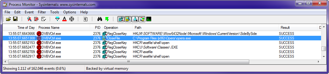

I have further proved that it's calling internet explore EXE directly, by writing a very cheesy test C# console application:
namespace fakeIETestapp
   class Program
       static void Main(string[] args)
           if (args.Count() >= 1 )
               Process.Start(@"C:\Program Files (x86)\Opera\Opera.exe", String.Join(" ", args));
           else
               Process.Start(@"C:\Program Files (x86)\Opera\Opera.exe" );
and saving it is:
C:\Program Files (x86)\Internet Explorer\iexplore.exe
Guess what, when I click on Web Interface on the RecordingService tray icon, it now opens in Opera by calling the InternetExplore EXE (that is usually not there)... Seems like you are doing bad hardcoded paths rather than relying on shellexecute and using the windows hander for http and http protocols.
