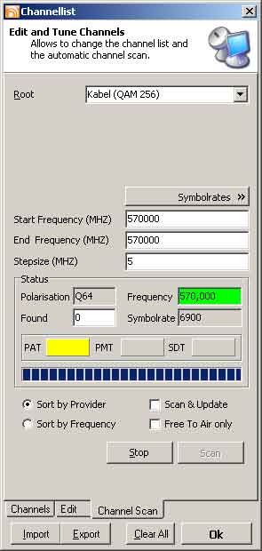

Blimp Posted October 1, 2004 Posted October 1, 2004 I’m not sure if I’m doing something wrong or it is a bug, but here is the deal.. I have a Technistar CableStar 2 PCI card and I can scan for channels using the DVBViewer TE version (using as Root: Kabel (QAM 256)). But using the full version, the channel scan doesn’t find any channels (also using the ‘Kabel (QAM 256)’ as root). And I find it strange that the QAM in the status windows displays Q64 with a yellow PAT light. I shall post some screenshots to show. I can export the channel list in the TE version and import it in the Full version and the viewer works fine. Anybody some idea? Quote

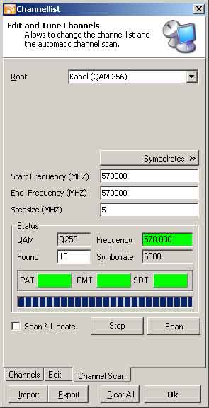

Blimp Posted October 1, 2004 Author Posted October 1, 2004 Here a screenshot of the TE version: Quote

Derrick Posted October 2, 2004 Posted October 2, 2004 You probably won't find any answers in the faq. This looks really strange.. ..maybe there's something in the SI that the parsing routine of the pro version doesn't like (if there is a difference between TE and pro). I wonder what @Griga has to say. Could you tell a little more about your cable provider and the programmes? Quote
Blimp Posted October 2, 2004 Author Posted October 2, 2004 Thanks for the quick response. The Cable Star is indeed set in the Channel list. The cable provider is Caiway in the Netherlands, this company is broadcasting digital for about a half year. Here is a link with the programs of there broadcastings. Since this week there are four stations which are modulated with QAM-64 and these stations are found using the QAM-256 root settings in the Full version. Its look like the QAM is divided by four or something, because when I use the root setting: QAM 64 (which is missing in the full version, but I used the .ini file from the TE version), the scan didn’t found any channels and again. And an other question: why is the Status window says 'Polarisation' should it not be 'Modulation'? Grz, Bastiaan Quote
