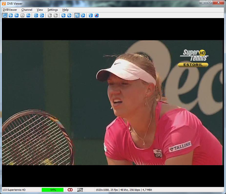

Yes, I can get the Super Tennis HD channel, that is a FTA channel.

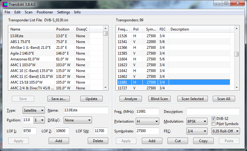

I have tried with Transedit also, the result is Found:0
Yes, I have set the modulation as you can see in the attached TransEdit screenshot.post-124837-0-80827400-1336397897_thumb.png

I can get other HD channel, Super Tennis, as you see in the attached screenshot.

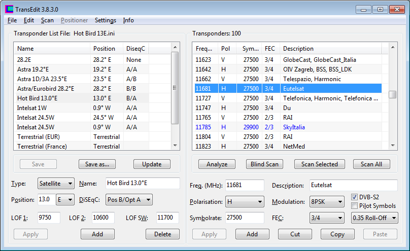

Hi Fernand,
Here are my screen shots. The only difference I can ascertain is that I have a slightly different file (look at the title) and it has the channel names, but you're right all parameters seem good.

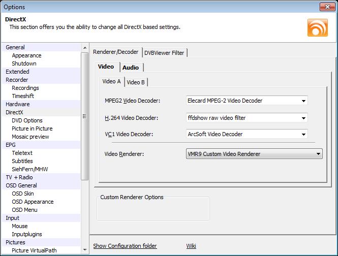

Hi ddchiera, may be my codecs are not correct. I attach a screenshot.
If you're not getting any channels when scanning, the problem is before any codec issue.

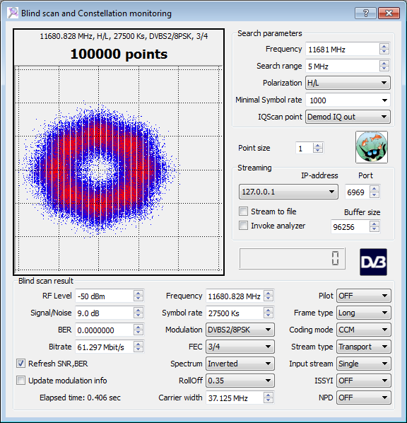

Here's the screenshot from Crazycat's Blindscan utility using the Technotrend card. It shows the pilot signal off, but again, that may just be for one brand of card.

Today the sky is not so clouded, and I managed to receive a weak signal from that transponder. Mostly garbage data, but enough to confirm the Pilot Symbols off is correct.
