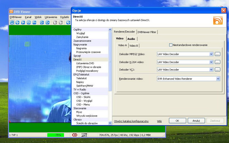

yggdrasill666 Posted May 10, 2012 Posted May 10, 2012 Heya I have problem with codecs(?), every codec i try use it shows video only for a second then is blank(SD and HD). Only VIVA works.. I have been try on win XP and 7, same problem My graphic card is ATI Radeon HD 4650 TV card SkyStar USB 2 support.zip Quote
blasgl Posted May 10, 2012 Posted May 10, 2012 I don´t see any obvious misconfiguration. To create a stable working basis use the LAV Filters everywhere. Then post a screenshot of the DVB Source filter in action while you are having the problem. Quote

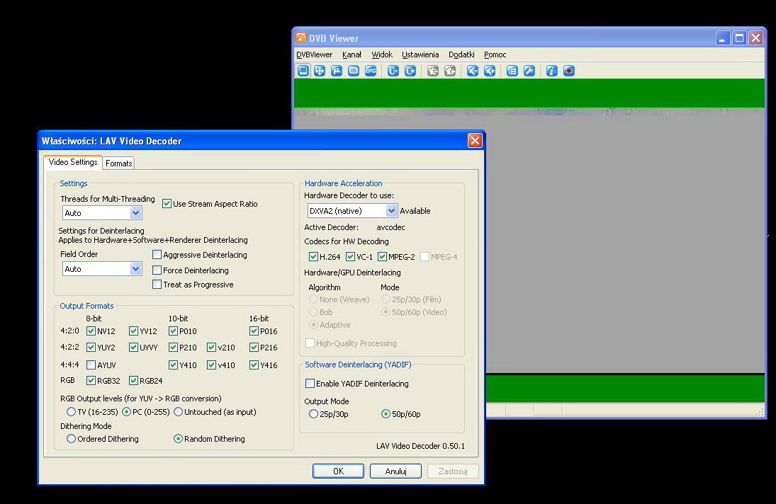

yggdrasill666 Posted May 10, 2012 Author Posted May 10, 2012 (edited) i tried every rendering video setting on LAV codec, still same. Video stops on first pic Edited May 10, 2012 by yggdrasill666 Quote

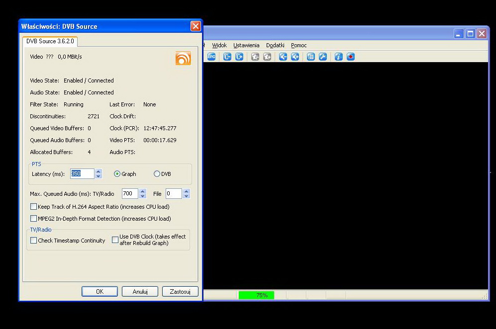

blasgl Posted May 10, 2012 Posted May 10, 2012 (edited) in the first screen you posted click the flag "use custom renderers" and select the EVR custom in the drop box below. Right click on the tv picture->view->filters->dvb source post a screenshot Edited May 10, 2012 by blasgl Quote
blasgl Posted May 10, 2012 Posted May 10, 2012 (edited) I think you have no signal. Either lost on the sat cable or in the usb receiver. Or the SkyStar drivers are not installed properly... Edited May 10, 2012 by blasgl Quote
yggdrasill666 Posted May 10, 2012 Author Posted May 10, 2012 Nope. VIVA channel works which means signal is fine.. Quote
blasgl Posted May 10, 2012 Posted May 10, 2012 The source filter is showing thousands of discontinuities. You´d better look where your signal is lost: reinstall the usb driver from your skystar usb stick and connect it DIRECTLY to your computer on a USB 2.0 port. Quote
yggdrasill666 Posted May 10, 2012 Author Posted May 10, 2012 Well works now. Somehow usb 2 was disabled at BIOS heh Now problem is with HD channels, signal jumps from 50% to15% Quote
